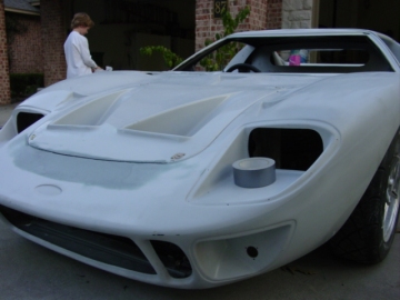

I think you're right Ron. Mark, I took up all the slop with a couple of hood bumpers out of a wrecking yard (late model Mustang), and than combined with the latches makes it good across the front. I did add some body filler across the front of the spider and the front of the clip to make things flow better. But I think I will add a couple of pins in the back center of the front clip.

Here's some of the front clip that I had to fill
