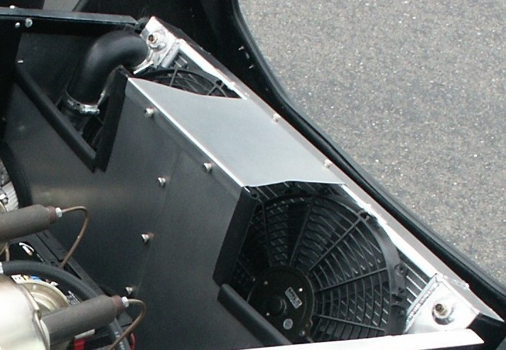

This is another way of doing it (Not my design). I copied what Bud Jones had done on his car. If you want to keep the "old style" twin nostrils, this will do it. The new designs that you guys are talking about eliminates the use of Ali panels in photo.
