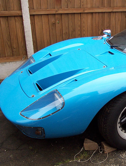

How they looked before...

Simon, that looks really, really nice !
BTW, did you decide to use any type of "gasket" between the perspex covers & the f/glass bodywork ?
My headight covers are just bolted straight onto the f/glass for the present, but 2 or 3 kms on a flat-bed tow-truck in the rain has already left muddy tracks through the dust in the recesses under the covers. All my cover bolts run into "helicoils" in the f/glass, but even they may not go the distance if I have to remove them every time I wash the car !
Any ideas ??

Paint a 1" strip around the inside edge of the cover with
black paint. That will cover any caulk or weatherstrip. Look
at the photos of the cars above, for reference. Looks
pretty good and is quite functional.

The headlights have a stick on foam-type sealer applied around the recesses.
Simon

My car has a thin gasket around the opening as well. When I painted my light recesses I used the inside edge of it as my "taping point." It made it nice as the black gasket hid any small errors in taping.
I put a small dab of silicone on the end of each of the screws when I replaced them in the covers. In the past I've had some vibrate loose over time, so this seemed a great time to address that issue.

Paint a 1" strip around the inside edge of the cover with black paint. That will cover any caulk or weatherstrip.
[/ QUOTE ]
Some people used the body color paint instead of black paint for the 1" strip. In either case, the 1" strip nicely hides what ever you use to seal the covers.
The same technique can also be used for the rear window and the doors.
