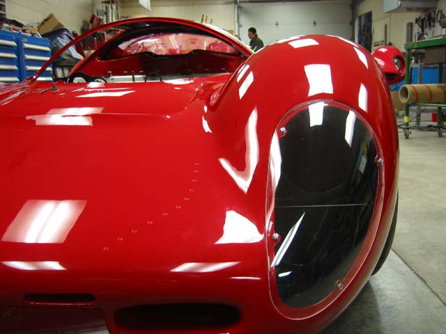

mlevea's Avatar
2 Tenths
Join Date: Apr 2002
Posts: 202
Rep Power: 9 mlevea is on a distinguished road
Re: Painting headlight recesses
Here's a picture of mine.
I painted mine in a black satin finish.
From what I've read the drivers complained of the reflection of the headlights off these surfaces mostly in the rain or fog at night. It basically created a halo that was hard to see through.
I block sanded my recesses, masked off the entire front clip and sprayed.
Mark

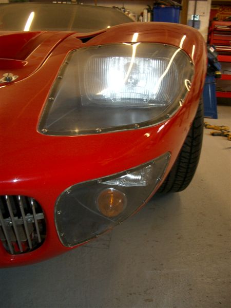

I've been thinking about doing this for a while, too, and this topic finally got me off my arse this weekend. Here is a shot of my car with the left side recesses done:
And another of the left side. I also used satin black spray paint. After a bit of block sanding I taped off the lights, adjuster screws, etc. and then covered the rest of the car. It took about 90 minutes per side and I really like the way it looks--more sinister than before:

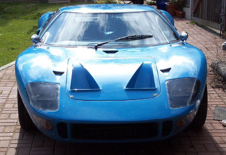

OK, done them, this is what they look like.
Simon

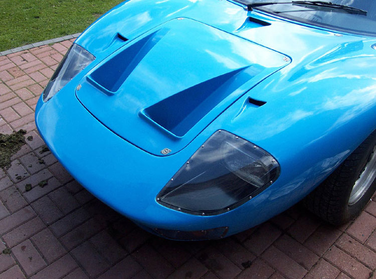

And this....
