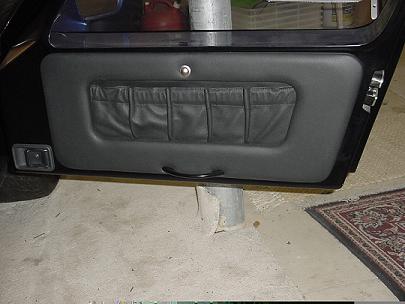

My door panels are covered in leather, with the "leather pockets" set into a recess. Each panel is hinged at the bottom, and latched at the top, for access to the compartment inside. If you'd like, I'll post a photo or two.

The inside of the door compartment is carpeted. The panel
has a simple piano hinge across the bottom,a satin
finish, stainless catch at the top, and a pull handle near
the bottom.

Bill,
Could you tell us what kind of door mechanism and hardware you have. It looks much more functional than the sill operated one, and you don't have to break your neck trying to reach it.
wbmusarra is offline
Old 03-26-04, 05:23 PM   #9 (permalink)
Fatal Attraction's Avatar
Fatal Attraction
Join Date: Nov 2001
GT40: Ex-DRB #35
Posts: 1,498
Re: Finishing the interior of the door?
Bill,
Do you mean the interior door release handle and hardware?
If so, it is a cable/bellcrank type latch. Two cables, one
for the exterior handle, one for the interior handle, with
a common bellcrank at the latch/striker.
It is very easy to reach, even with the harness on.
I like being able to make a hasty exit! You never know
when that may become a necessity!
As far as the donor car, I can't help you there. Sorry!
