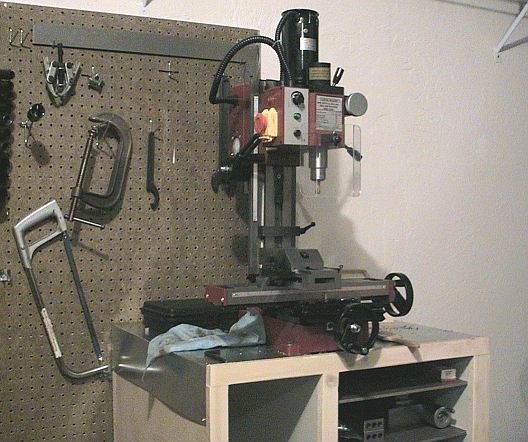

Make your own. That's what the milling machine is for. [img]/ubbthreads/images/graemlins/smile.gif[/img]

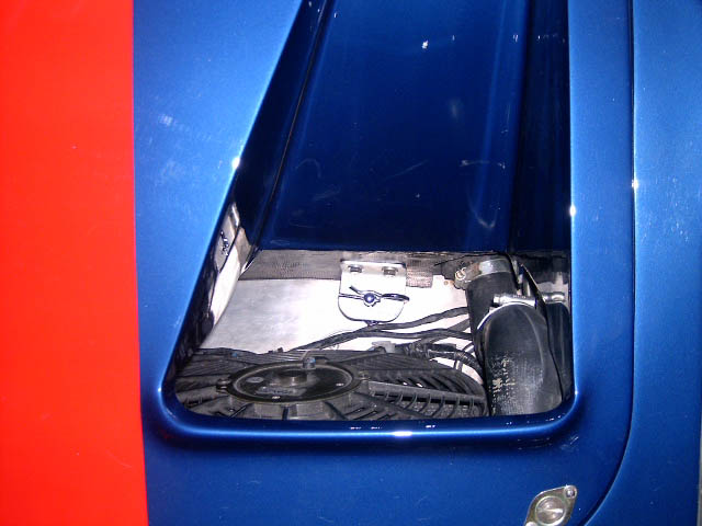

The CAV's have a pair of hood latches in the rear to provide a more secure hold-down than the side clips. You can see the engine compartment side of things here:
The release handle is made of plastic and has been known to break (or come off) [img]/ubbthreads/images/graemlins/shocked.gif[/img]

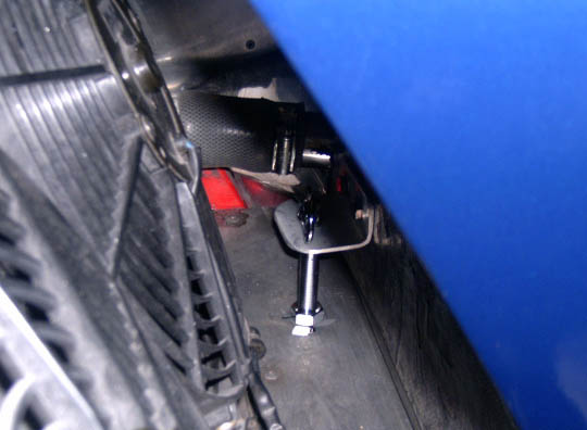

I hope you never wish you had done something like this.

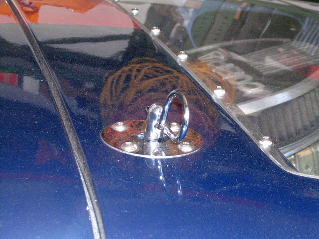

I liked the resulting piece of mine so much I did this to the front nostril cover.

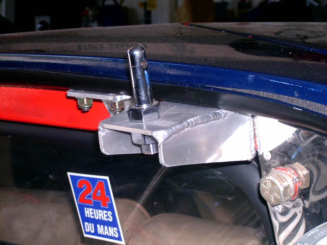

Missed this one, I would be affraid to do it any other way.
