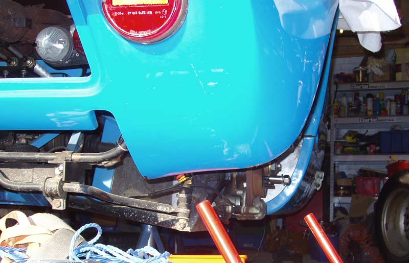

Ok this may be a stupid question but........
Keep in mind this is a scratch build I am doing. I am trying to line up my rear clip and I cant help but notice that the lowest part of the body is a good 3 1/2 inches above the bottom of the frame, looking at various pics this may be correct but there are no pics that are low enough to the ground and detailed enough to convince me this is right. Can anyone confirm??? Is this how it is supposed to be or is the rear clip extremely distorted? Thanks

I'm not sure EXACTLY what you mean, but do these pics help?
I tried to position the camera at about the same level as the bottom of the sill.
Simon

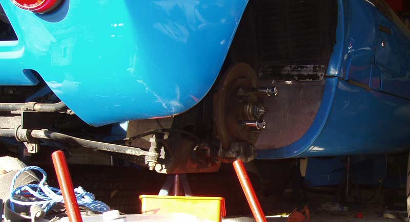

From another angle.

Wow, thanks very much. I had no idea that you would be able to see that much of the car hanging out the bottom. I guess it is right. All the dimensions I took tell me the back end of the clip needs to go up another 1/2" even.
Thanks again
