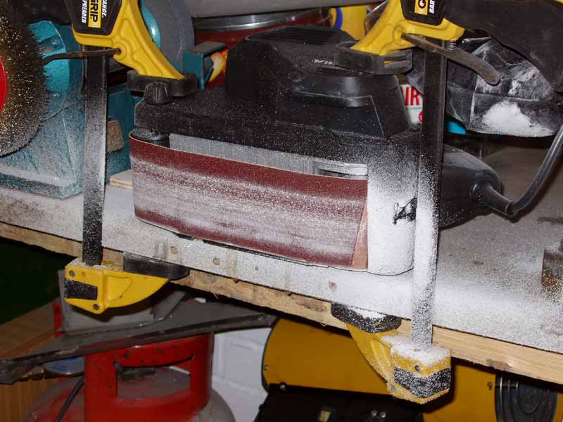

Just thought you'd like to see my solution to trimming the light covers to fit.
It's a cheap belt sander clamped to the workbench.
The belt sander was only £29.00 (I've got a number of other jobs around the house to do with it as well) and clamped down tight, it makes the perfect toolo for sanding down the covers.
I put masking tape on the covers and trimmed it with a razor blade so it was flush with the edge. I then positioned the light cover and drew freehand where it needed trimming.
Cutting very carefully, it's possible to get a really nice smooth edge and as long as you don't hold the cover in one place for too long, won't butcher the cover.
Simon

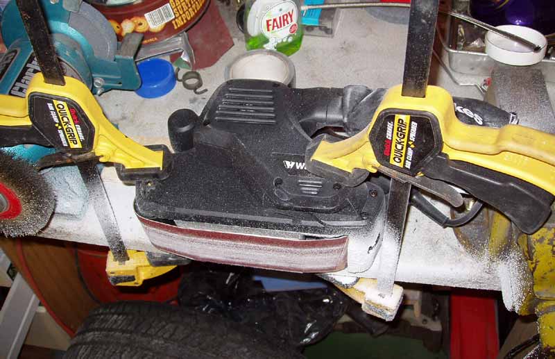

Another pic

Without trimming the covers to fit the recesses, it would be very difficult to see exactly where to drill the holes. It could mean that you end up sanding back too close to a hole that's already been drilled.

Great minds think alike! I did exactly the same this you are doing. I laid the cover in position and used painters masking tape to outline the impression in the body. I then sanded away, slowly bringing this size inline with the recess.
I then placed the cover in the recess and taped it down. Then, using full taper Plexiglas bit, I drilled location holes for all the screws. I then removed the cover and drilled the holes in the clip to an appropriate size for nutserts. I finished off by putting sticky back foam tape around the perimeter.
