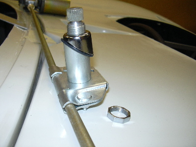

It seems that where the spindle of the wheelbox pokes through the bodywork is designed for a level surface. It has a 45 degree angled spacer so the wiper spindle is parallel with the screen. The spider mount where the wiper pokes through on my 40 seems to be already parallel with the screen so I would presume you just have a normal collar with 90 degree ends. What do you guys do here - have a new spacer made up ?

I had a similar problem...a little time on the lathe and a few minutes on the buffer wheel produced a fine looking spacer out of stainless. I think even a small lathe could make this part easily. I used a plastic washer between the body and spacer and all looks good.

As I recall, I just used a flat washer on either side of the body and threw away the angled spacer.

I called SVC and they already supply normal style spacers in black plastic for the Lancia Stratos replicas so they just swapped mine over. I'm now looking for a wiper arm - I've seen them in Europa but they are finished in chrome and I want a black one. Anyone know who supplies them in the UK ? the problem is the spline fitting as most modern cars use a bolt on the end / outside.
