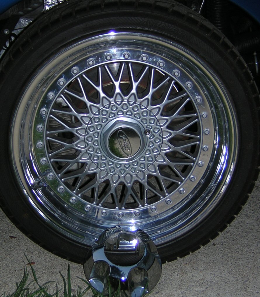

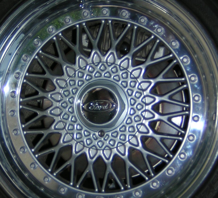

Re: Wheel Centers
To late Joseph. I only paid $25 for the four, so its not like I am out big bucks. I chucked a 1/8" grout removing bit (Dremel or Zip, can't remember which) in my drill press and took my sweet time cutting them out. Then sized them using a grinder, 50 grit/80 grit sanding belt (the 80 being about 1/2 worn out). I also had to thin them quite a bit using the two sanding belts also. I am pleased with the results.

Re: Wheel Centers
Here is the wheel and the leftovers:

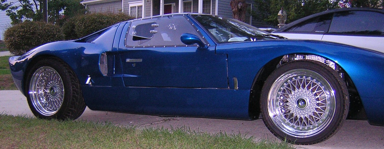

Re: Wheel Centers
and a shot of the side of the car.

Re: Wheel Centers
Lynn,
those wheels look really good on the car
but I bet they are a bugger to keep clean!!

Re: Wheel Centers
Lynn,
Boy does your 40 look great and what a beautiful color blue. Before I go any further I need to explain that I was ill and on a prescription drug when I first read your post and suggested you print the centers. Some how I got the word (steering) before wheel and I was talking about the " 5th " wheel and you were talking about the other 4 wheels. As for the glue, I use spray adhesive on both parts that will be glued together then let dry for a few seconds then push them together and it works very well on parts that even get wet. [img]/ubbthreads/images/graemlins/confused.gif[/img] [img]/ubbthreads/images/graemlins/grin.gif[/img]
