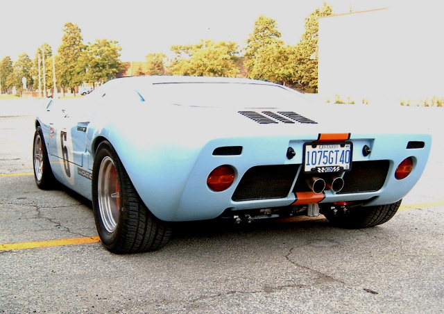

Having a look around at original GT's I have seen some vents on the rear that I have not noticed before. Can anyone point out what they are for? Releiving pressure from the rear clam?

Dave, yes, most MKIs have the vents like that picture. Some cars like P1075 left them out completely to let out as much air/heat as possible. MKIIs had screens.

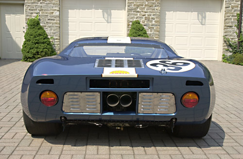

Are you talking about the stainless louvered covers either side of the exhaust or the 3 holes at number plate height (or where a plate would be on a road car)?
I must say I had not noticed the openings at the sides of the rear but would think that it could help remove heat / pressure from the rear corners of the engine bay.

While your question is a good one, that picture is a bad example to use for "original" vents. When the car was new the only vents on the back were the aluminum ones on either side of the exhaust. The three holes along the top were probably added when the car was restored.
If you want to see what the tail of 1036 looked like when it was new, take a look at John Allen's "GT40: The Legend Lives On", page 80 (it's the only black and white picture in the book). If you look closely at the picture of the original car, you'll see that the louvers get wider as the aluminum panel gets wider, something that they didn't bother to do when they restored the car.

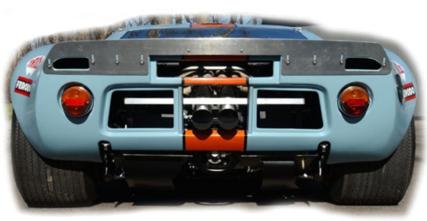

What is missing in the picture in Dave's post that nearly all cars with these high wheel well vents had is the adjustable spoiler that goes over them. You will see this adjustable spoiler on a lot of the Mk IIs as well. The spoilers have slots in the ends that match those in the fibreglass so that as it is raised or lowered the vents remain unimpeeded.
I don'k this know for an absolute fact, but I believe that this is one of the many tips, tricks and parts Ford passed on to JW for his campaign of MK Is in '68 and '69. As originally configured the early MK Is got real squirrly at speeds well under 200mph. The one other thing that was changed was the ride height of the car, which was not symmetrical front to back. The changes were primarily developed by Ford in wind tunnel testing. If you've seen the interview of JW, he talks about all the goodies Ford gave him when they pulled the plug on MK II and IV cars after the FIA effectively outlawed the big blocks. Those "goodies" included a lot of setup information in addition to hard parts for the cars.

I found this link http://www.racingicons.com/gt/1076.htm that shows the spoiler Lynn mentions on 1076. I also shows a detail shot of the corner vent I was talking about. THe text says it was a added to relieve pressure from the Wheel Well.
Has anyone replicated this spoiler for their Kit Car? It looks fairly simple in design but it would be great to know what the material used was. How high it could be adjusted into the airstream etc.

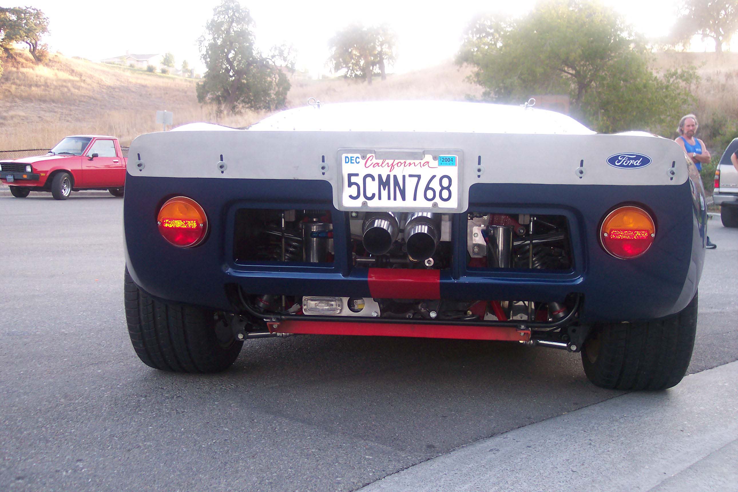

The front canards and wheel arch spats appear to be used on some of the Gulf cars for the most part. I have no idea if they proved to be effective but the Mirage cars were fitted so who knows? The rear spoiler looks to be left off 1036, maybe stainless steel?

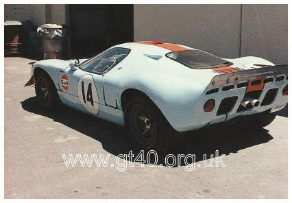

The GT40s went through almost as many variations as the Cobras, so goes the discussion of what's correct/authentic etc. but I'm going to leave that can of worms closed
The vents above the tailights were thought to improve rear brake cooling by reducing the air pressure in the rear wheel arches, therefore more air would feed through the ducts suppying air the the rear discs.
Im not sure if that was ever proven but they sure look cool.
The lisence plate recess was openned on race cars under the same logic, although to simply increase airflow and heat escaping the engine compartment.
The chin fins and adjustable rear spoiler were used on short tracks to increase downforce (decrease lift?) as the cars did get light at high speeds.
The new front nose introduced in 1966 and used on virtually all GT40 replicas solved most of the high speed lift problems, so much so that I can say at speeds well above 175mph these cars drive straight as an arrow.
Interesting how much technology was hoarded by different teams fielding cars for the same company with the same objective in mind...

Kalun, Interesting concept. I'd like to instrument one of our cars to find out what goes on regarding air pressure in the nose and under the rear clip. Areo is very unpredictable but ultimately makes sense when the data is analized.
On the CAVs the radiator is significantly wider than the original so it takes all the air coming in the nose. Additionally the hood vents, both daul nostril and single outlet are full depth and go right down to the bottom of the rad. That probably contributes to the excellent high speed maners of the CAV cars. I know Roy Sales of VIP Classics was clocked on radar at over 175mph.
All the body opennings have a maximum flow rate, once that's been attained the air just flows right on by, also you're at maximum drag from the ducts.
I suspect when you're really going, the engine cannot take all the air available from the rear window plenum (checkout vents in rear window of the Mirage) so air would only come in as fast as the engine draws in the case of a close fitting cold air box, surplus would spill off under the clip. The rear vents beside the tailpipes are several times larger than the total air entering the roof and side vents, take away the engines' cfm and let the air out the back into a low pressure area and I wonder if there would be any pressurizing of the engine compartment. hmmmmm...
