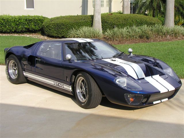

Try 1/2" top stripe, 1/2" gap, 2" middle stripe, 1/2" gap, and 1/2" lower stripe is original (4" total).

Here's how it looks.

Thanks, the detail on the side of your car is exactly what Im targeting....saw your posting recently on the workover and was impressed....I am looking forward to this project particularily beyond the bodywork and painting.

Steve, When you get your stripes put on think about the diameter of any number circle you might later want to put on the car. Putting the stripe a little lower on the sill makes it easier to apply a rondell with a number in it latter.
Just a bit of learned infromation.

Good point, looks like Veek dropped his a little. I have seen a number of cars with the striping starting just below the door and correct that the rondell overlaps the sill. I would probably had made this mistake had you not mentioned.
