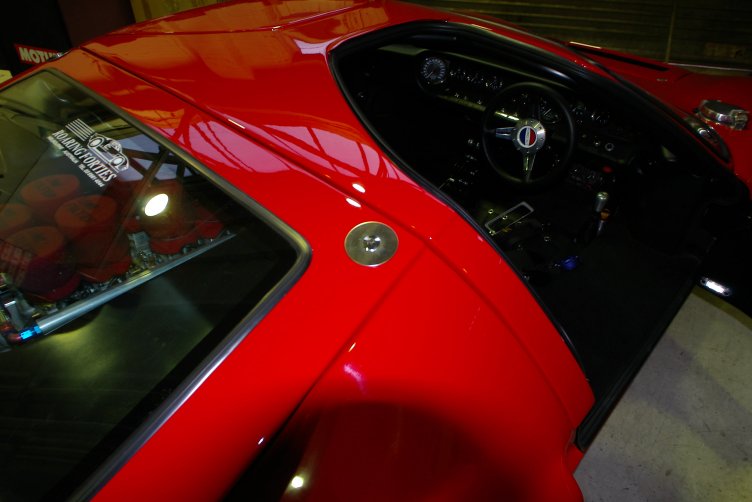

FYI.
Tim.

The above lock is almost flat, takes a key and (I think) looks quite nice.
Tim.

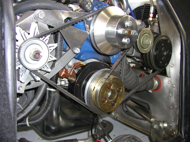

Not a problem. On a CAV, take out the seats, take the two bolts off the engine access panel inside the car, open it up and voila, you're in. Then reach around the compressor or alternator (depending which latch sticks) and go to the latch and open it with some locking pliers/screwdriver. Takes about an hour.
That said, an ounce of prevention on this is far better and make sure it's all connected and tight before you close it up.

Here is what it looks like with the panel off.

Thanks Veek makes me feel better about removing mine and readjusting thr cable length to get positive lock. Just figured out another alternativ is to weld the inner nuts to the plate so the assembly can be removed from inside the cabin by removing the bolts whereupon the tail section comes up with the latch assembly attached
jerrymcglothin is offline
