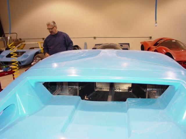

A couple of pics of the fit of the RCR40 doors

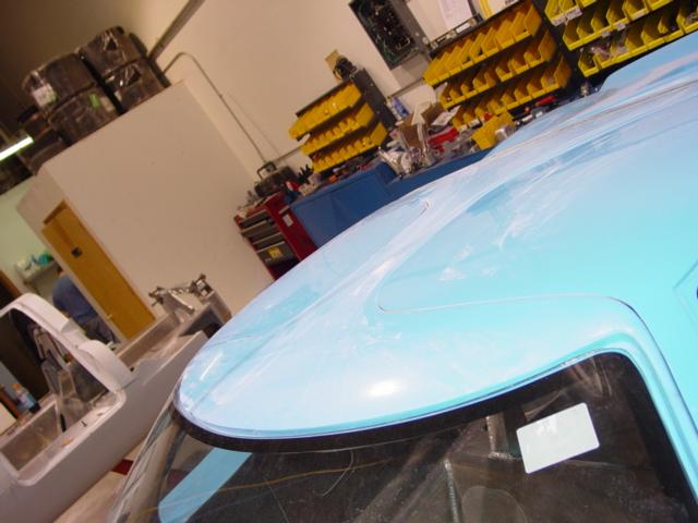

another

Hey Fran, nice looking cars

Might be 10 and 11 [img]/ubbthreads/images/graemlins/smile.gif[/img]
Sandy

Fran, super nice fit on the doors ,thanks for posting the pics. I will strive to get mine to fit as good as that, it makes me more convinced to purchase the Gulf flares for my GT . Soon. Kevin
