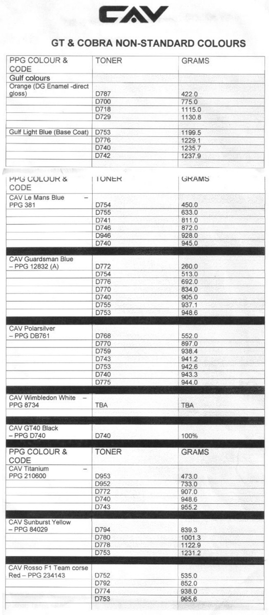

Hi Simon,
Here is the CAV Paint Code List for Standard, Gulf and Cobra (ex Shelby let's not go there) colours.
These are PPG tint bases and weights. I apologize to those I promised to post the codes for earlier, been a very busy boy lately. Glad to help out.

Also, provided the color codes above, but apparantly the base colors are only available to PPG repair shop locations (some Global Installer system marketing thing they have). Don't understand the what's/why's of it, bottom line is the local paint supply store doesn't have the base (toner) numbers listed. However, if I knew the finish volume, the guy I deal with is willing to call a shop and have it mixed for me, but since he isn't the one doing it, wants to eliminate all risk. Therefore wanted me to find out what the mixed volume is. He speculated based on the gram counts that is was a quart to quart and a half.
CANUK40: Do you know what the finished/mixed volume is?
