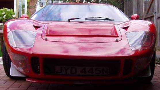

Re: Front number plates.
A small aluminium bracket, fixed inside the nose will make the numberplate as unobtrusive as possible (and I don't think causes any cooling problems) the front plate has been fixed to both my GTD's this way, although it must be said the B&W plates look MUCH better
Simon
Close, brighter pic
