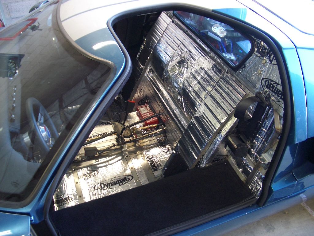

Hi Ray,
I spoke to you just before you bought your car in Phoenix. Congratulations and I hope you are enjoying the car and doing all the personal changes that will make it yours.
Many of the questions new owners ask have already been answered but they are just hard to search out unless you already know were to look. Try searching “cabin sound insulation.” I have extensively worked on the sound level of my car and eventually got down to about 85 db at a 75 mph cruise with total cabin sealing, Dynamat, a low 5th gear ratio, and tires.
Good luck with your new project and give me a call if I can be of help. Here are three pictures.
Bob

Wow! Thanks for the suggestions. And thanks Bob for the pix. I think I will definitely change the Thermotec around the roof of the engine bonnet with the new Dynamat heat/sound barrier. Unfortunately, the interior cabin is all upholstered but I'll remove the seats this weekend and see how difficult it will be to undo the liners. I'll post pix when I'm done.
