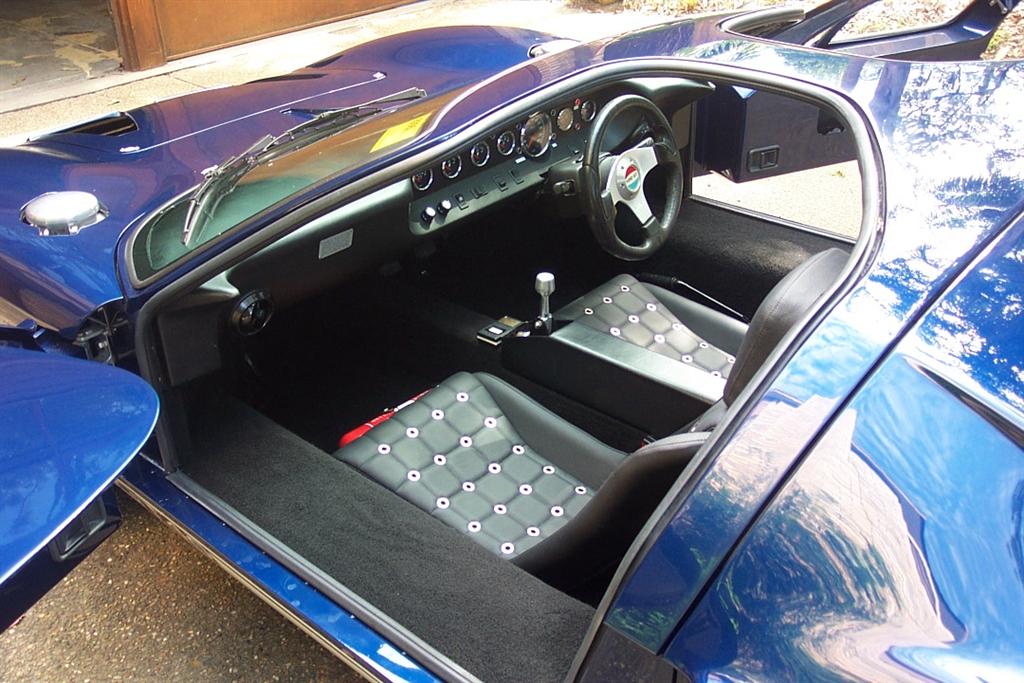

Same situation here as with Neal's above. The pichweld is the same as that around the rest of the door, & clamps onto a f/glass lip sticking up from the sill.
Kind Regards,
Peter D.

Re: Sealing the doors
Thanks for the great picture Peter.
BTW - your car is gorgeous!

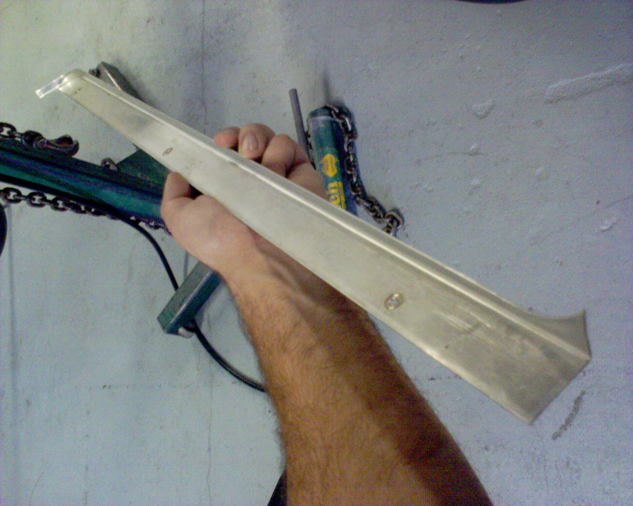

Bill D
I'll show you a series of RF trims for weather sealing the bottom of the doors, about 3 or 4 photos...
The flat section with the holes sits on the sill and the pointy end closest to camera points towards the back on a RHS door, like this:
