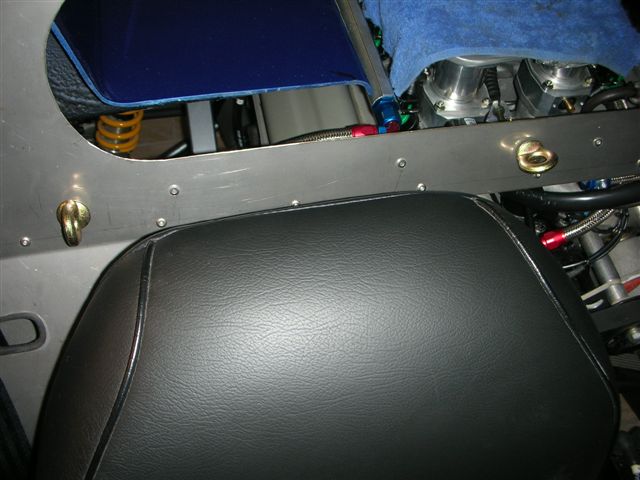

I would be interested to see the pictures of your harness attachment points.
I am in the process of fitting my four point sabelt harness and the lack of room beside the seats has caused some fitting issues as there is not enough room to install the eyebolts provided. This along with the lap/sash belts for ADR compliance has required some extra thought and ended up with a proposed bracket design which may be more than actually required.

Peter,
I might be able shed a little light on your question of eyebolts alongside the seats. I have two sets of seats, the standard RF seats and the RF race seats on which Ross’s seats are based. The standard seats definitely do not allow enough space for the eyebolts to be mounted so the harness can only be used with the race seats. Even with the race seats fitted I have still had to fabricate a narrower set of eyebolts. Also, I have compared my setup with Ross’s (I hope I’m not giving away any secrets Ross) and found that Ross was able to re-claim some space by relocating (read remove) the panel between the seat and shift linkage.
With regards to the harnesses themselves, I’m using a 6 point Sabelts but I find that the length of the belt from the adjustment buckle to the eyebolt mounts on the lap belts to be annoyingly short. This length places the buckle between the tall-sided race seat and the car panel and makes it virtually impossible to adjust when the race seat is in place. The ideal solution in my case would be to fabricate longer eyebolts.

Thanks for you input Chris.
Your description confirms the dilemma that I have faced and since I have the standard seats, I am limited to about a 20mm space on each side of the drivers seat to fit my attachment points. There is a little bit more room on the passenger side but it is still fairly tight. As you have already experienced, I am in the process of fabricating customized brackets which will allow for the required attachment points to fit in the space available and the extra height should alleviate the issue of the adjustment buckle position as you have mentioned. I have also incorporated the attachment point for the lap/sash belt onto this bracket arrangement which should keep thing fairly tidy.

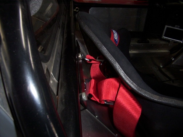

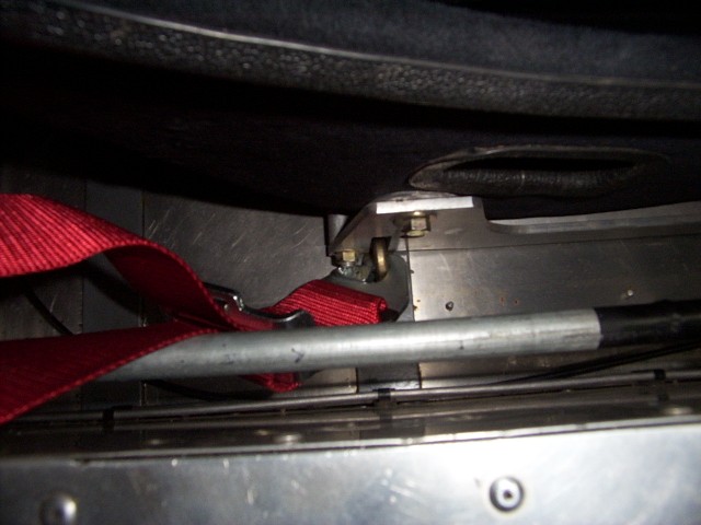

Graham you are right on the money with that explanation, I don't always tie all the points together as well as you did.
Peter and Chris

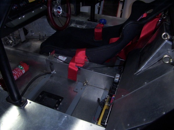

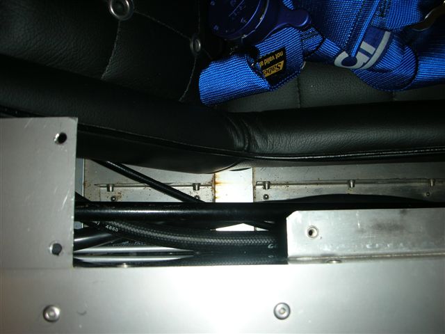

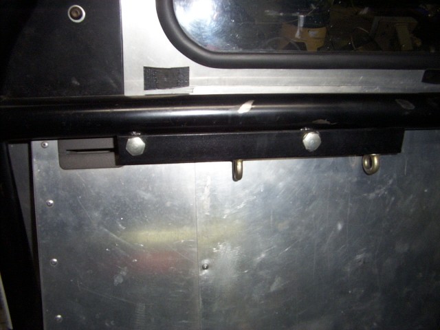

When I put my drivers seat in, I did intend to fit the gearshift panel and I have only tonight removed the aluminium angle bracket from the floor. So I did indeed have the space problem for the harness eyelets. I actually checked
the eyelets into the seat mounts and it worked really well. I will include photos of this later tonight when I post the promised seat photos.

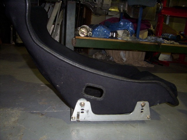

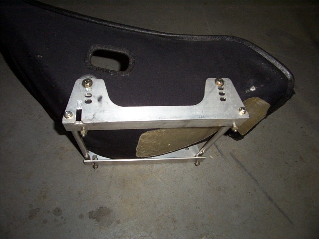

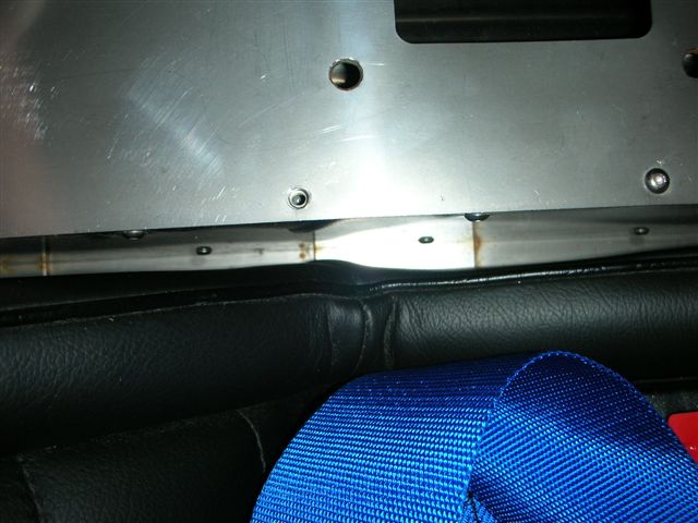

Photos of Ross' seats and mounting including belt eyelets.

Ross,
What seats are these? They look very functional with good side support.
