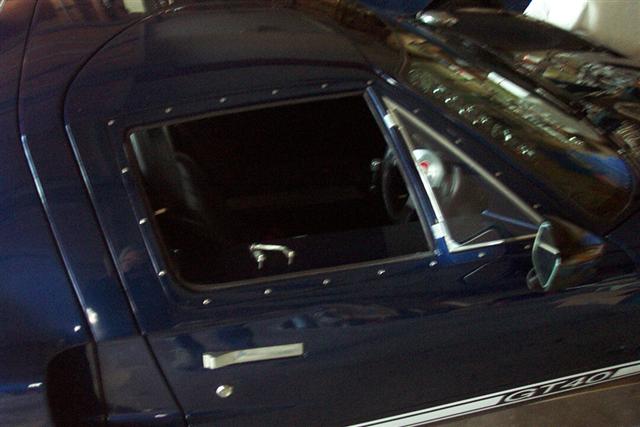

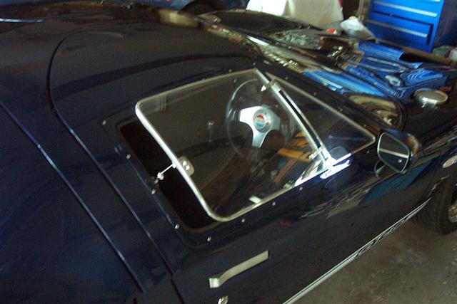

Perhaps you could have a look at the MKIII window option that DRB (GT40 Australia) offers. In essence, it is a f/glass frame that supports a fixed "quarter window" at the front, & a hinged main window - hinged at the front, with a "flip-over latch" at the back. This lets you have the back of the window opened up about 90mm - heaps of air flow. But the really nice bit is that you can just lift off the latch, & then swing the window out and lift it right off.
I survived one summer in Oz with both windows out (before I got the A/C working) - a life saver !!
The attached pics might give you a bit of an idea - if you would like better ones, just let me know.

Peter, could you post some detail pictures of your side window frames with the windows in and out? Maybe I can make something for the drivers side at least.

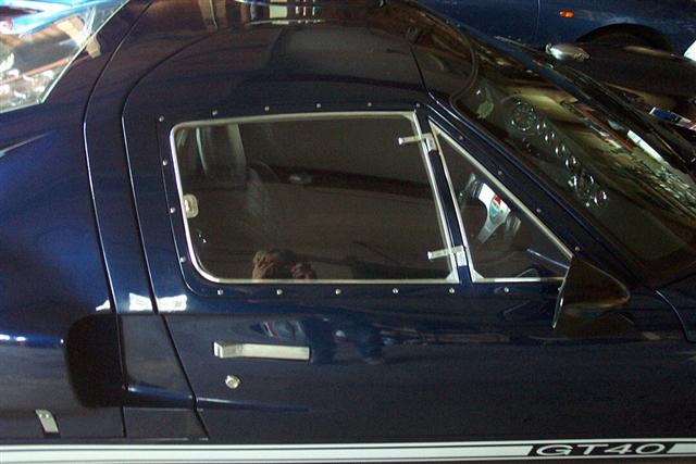

Pics of side windows attached :

Thanks Peter, I think I could come up with a homemade version using a standard lexan side window. How about making a drivers side with a large hole much like the original swing out small one. Then use a set of front hinges like yours and a single small screw and nut at the rear.
This would be something that could be retro fitted on existing side windows but just enlarging the hole.
