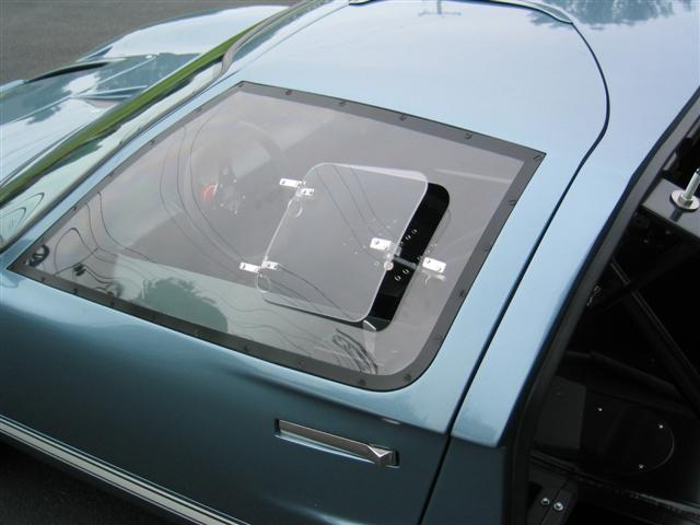

How's this Bill? I used 25 in each side window.

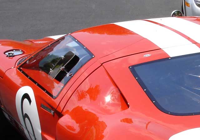

The way I did mine (including front lamp covers, back window etc.) was to remove the window, mask a clear strip a consistent distance from the edge and spray it black. The finish doesn't matter much because it's against the body and can't be seen. You'll see the paint through the lexan and it will look great if your coverage is good. I set an X-acto blade in a block with a tab on the edge (that hooked over the edge of the lexan) to use a consistent cut along the perimeter. You do end up scoring the lexan slightly when you cut through the mask, but it is invisible unless you're really heavy-handed.

I've got this pic of chassis 1049 - hope it's of some use Looks like 21 rivets/screws

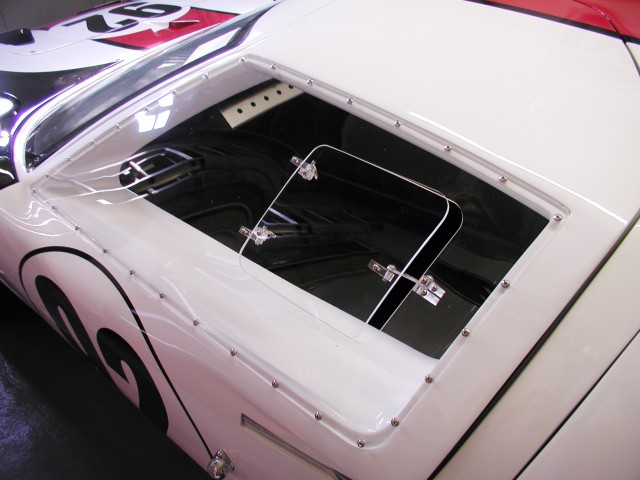

I counted a few more screws in the chassis 1010 pic I have so - monkey see, monkey do!
MDA supplied me with a 3/8th black gasket/foam for the windows and light covers but will probably only use it one the windows.
