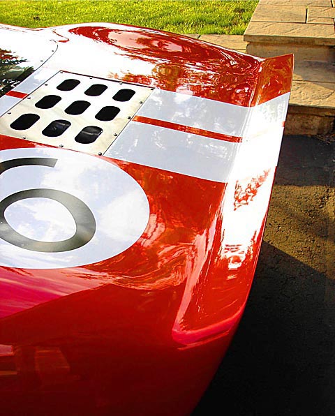

Bill, it's a GT40 and any opportunity to caress that gorgeous body with wax should be taken and savoured. But seriously, a high quality carnauba wax will afford all the protection needed for an occasional driver. Wax it two or three times a season and you'll improve the smoothness of the paint and the overall shine. I have never seen an all-in-one solution that has ever duplicated the quality of frequent waxing with the occasional buffing every few years. Check out Griots Garage for what works best: www.griotsgarage.com
