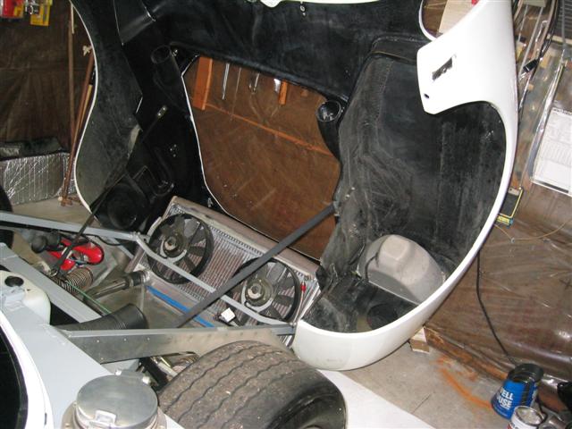

Here's a picture of how Safir does it.

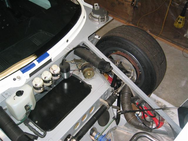

Another one for you .

Thanks Ron. I guess I'll have the body man glass in an outlet to run a 3" hose to the cockppit
