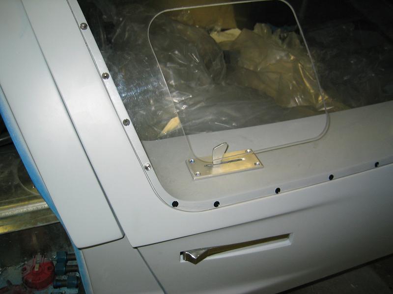

They look fine.
I fabbed mine out of aluminum.

Bill, those certainly might work fine. The ones I've seen have a pretty narrow slot - just slightly wider than the guage of the latch. These things can rattle annoyingly and I'm guessing if the slot is not a fairly tight fit then the rattle could be even worse.... On my car the throw from latched to open is not substantial - about 1/2 inch.

Cut a thin sheet of rubber (innertube material) and mount it under the plates, with a slit down the center it keeps the release from rattling and hides the slot in the fiberglass
