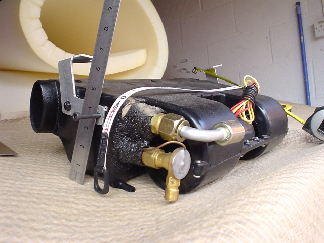

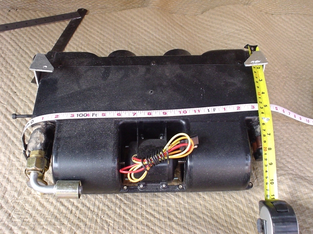

Here you go. The size is 16"x10.5"x5" (approx). If you go to Nostalgic, phone Jon up to speak to him, he will give you abetter shipping quote personally than the website will give you.
Bret
