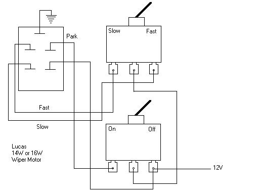

Here is how to implement the Lucas switch with park using two switches. Wire it up and try it.
Your diagram seems to be missing the standard Lucas "intermittent" setting (like the flicker setting for Lucas headlights).

BenL,
Actually, if you take the bottom switch between the straight up posititon and the on, it will do that. It parks when you take it all the way to OFF postition.
