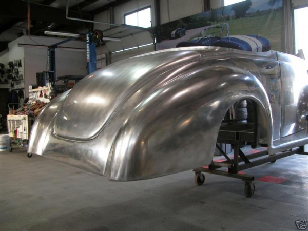

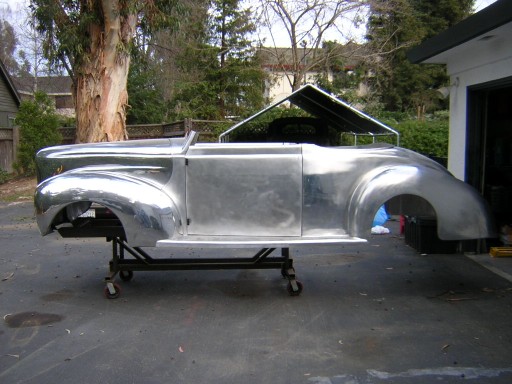

All aluminum body...Thought you might be interested in my newest project. It's the aluminum sister car to the copper 40GT that Ford had at SEMA in 2005 with the GT40 drive train and chassis. My aluminum version is awaiting a ROUSCH sbf and G50 trans. 100% hand hammered aluminum... I'm actualy scared to start working on it

We bow to the feet of the aluminum massaging master Beautiful work!!
So...please chime in on the above anealing discussion. What is your method?

What a work of ART!!!! Beautiful!!!!!!

Great looking job on the 40gt body. That quite a talent doing work like that. Do you work at Kirkham?
diecast18 is offline
Old 03-04-07, 02:49 PM   #29 (permalink)
40GT
Join Date: Mar 2007
Posts: 2
Rep Power: 2 40GT is on a distinguished road
Re: Ideas on shaping aluminum
It's not my talent... Kirkham made this aluminum body before they made the copper 40GT. I own it now and started checking out the threads on this site to get ideas on chassis and motor combo's. My other cars have flathead's and bajo rear ends so this is a stretch for me.

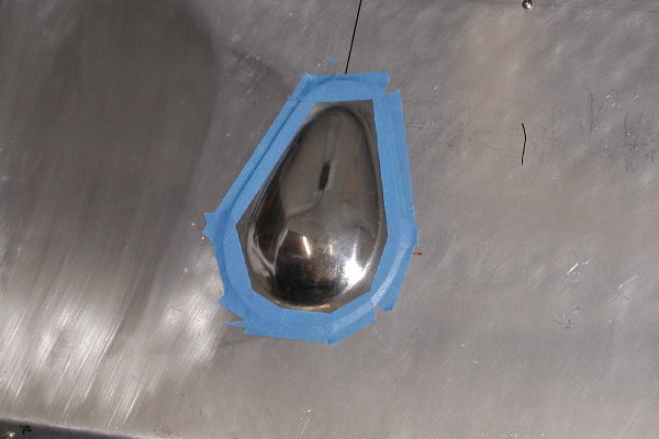

Brian your part done, Yes guys the first thing i did was annealed it.I use a Sharpy it burnes off at annealing temp. you can also use the sutt form torch to cover metal and it too burnes off at annealing temp.then you let part air cool!! Do not quench aluminum!! Let air cool to room temp. This part was very work nardened. A little english wheel and it looks beter. I'll ship it to you monday.

As you guys know, I wanted to shape a little bump out for my firewall to clear the water pump pulley. After a little banter, Randy kindly stepped in and offered his assistance. It turns out that for little more than a few pms and some stamps, I now have a nice firewall blister as attested to by the attached pic.
Who would think that a) I would post about this for help? b) that Randy would see my post and c) that he then would be kind enough to shape my part...coincidence or perhaps just good timing..
For those interested, the part will not be covered as there will be no carpets in the car.
Thanks again Randy
