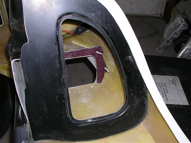

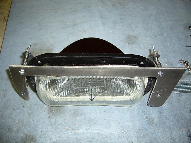

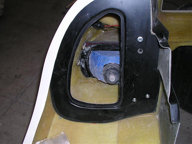

For your question, check out the attached pics. I too had the biggest mental gap looking at the brackets and hearing the concept. A call to Fran and a perusal of JayPSC's thread got me on the right track. Long story short is you fab a bracket out of alu or flat stock (super easy), fit some bolts into it as bracket studs, and glass it into place. Unfortunately I didn't take many pics in process but the attached show the end result (albeit from a little bit afar).
PM me your email address and I can send you a few hi-res pics of what I did. Honestly it is pretty simple once you get through it mentally. Unfortunately it's rather tough to type up a description though.
Edit: first one shows the flat bracket I made with the small bolts held in like studs and prior to fiberglassing them in. The second shows the lamp held into the bracket and the bracket mounted over the studs with springs and thumbwheels. Not completely easy to see but I do have higher res of these and can take others if you need.

Jay's pics (hopefully he won't mind):
The springs go on the studs, the bracket with the lamp body goes on, and the thumbwheels (w/lock nuts) hold the bracket against the spring to give you the ability to align the lamp. Just remember to leave enough clearance around the lamp body and the opening you cut.

Looking through Rob's thread, he has also posted a great pic which shows the final product prior to glassing in. Way better than any pic I could take now.

Just the job - that's very clear now. Many thanks for your response.
At the risk of stating the obvious, perhaps we had better point out for those about to start that the headlamp in the pic above is upside down (note the arrow on the glass)! Is it me...............???

Yep - there isn't enough space above the lamp body for the fabbed bracket to fit across the top. It's U-shaped and spans across the bottom only. It'll be obvious when you start the fab but make sure you do keep the lamps correctly oriented...

Hey Jeff,
The pic above is my assembly, so thought I'd chime in. Chris may have done similar, but I am not aware. The studs and thumb screws were left over pieces from a gauge install from a previous build. The spings are "push" syle from my "spring jar". I just hunted through until I found eight the same in the desired strength. I would imagine a good hardware store would have all these pieces.
