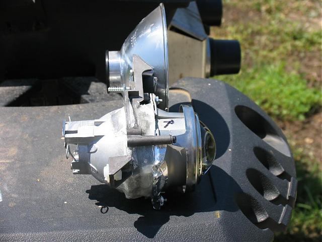

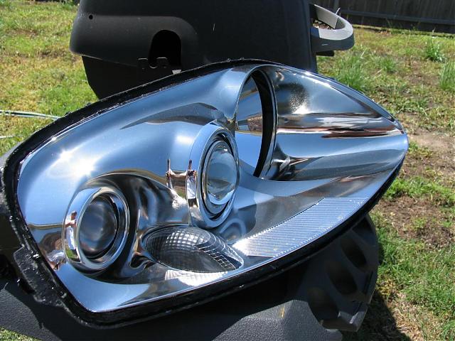

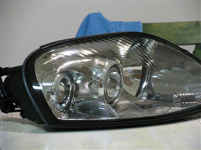

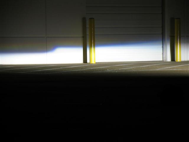

John, interesting points! Many of the 90's era cars here in the US were fitted with halogen projectors, so getting a "good" HID conversion with the right optics and cutoffs means changing the entire halogen assembly over to the correct D2S or D2R type.
Aftermarket HID kits became illegal in the US because the kit manufacturers were simply fitting halogen bases onto the D2S/D2R HID lamps and they sold tons of PnP Xenon kits that way. The result was a lot of unfocused light being thrown out, usually with the wrong cutoffs, which blinded oncoming traffic.
My latest conversion began when I installed new Euro spec ECE glass headlamps in my car, and reinstalled my old set of legal aftermarket HID's in them. The sharper cutoffs of the ECE's made the optics mismatch much more apparent than with the old US DOT headlamps, and there was way too much beam rising on the right side, blinding drivers that I was overtaking. The cutoffs looked somewhat like this: _____/ _____/ This problem is described in more detail on Daniel Stern's excellent lighting website: http://www.danielsternlighting.com/tech/bulbs/Hid/conversions/conversions.html
The only solution was to disassemble the headlights, cutout the halogen projector assemblies, and refit them with proper HID projectors, made for the D2S lamps. Not being particularly good with a Dremel, I farmed the project out to a mate who'd already done it, and here are a few photos showing the process and the final result (these are Acura projectors, Toyota/Lexus Denso ballasts, and Philips 4500K lamps):
