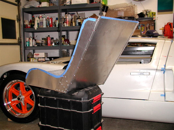

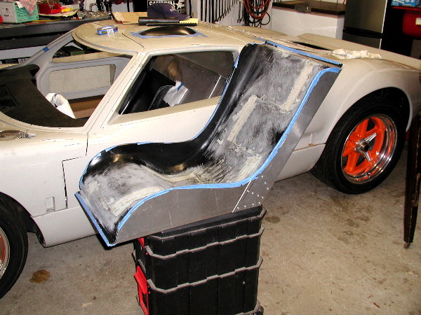

Like Howard, I am short on dough with my build so I have also taken it upon myself to build my own seats.
Starting off with a pair of fiberglass shells from Bill Hough , I slightly widened the driver seat and used left over ali sheeting to make the back, sides and bottom which will be glued and riveted. Here are results so far. I still need to cut slots for belts, but you get the idea. Current thoughts are to inject expandable foam between the shell and ali to provide stiffen the structure. Covering will likely be nomex as my seat cover guy does a variety of work for the firemen up here. Seats are fixed mountings, but my pedals are adjustable in multiple positions fore and aft, left and right through a matrix of holes in the base plate. I'll post some pics later on after they are covered, and oh yes they are very comfy and should require very little in the way of foam padding.
Brian

Looking good, Brian. I am impressed with the way you guys can knock up a racing car with tin snips, rivets, and bits of scrap lying around the workshop. Really encouraging for guys like me who haven't got a 40 yet, or enough of the folding money.
Dalton
Howard Jones
Hell YA!!!! We don't need no stinkin money!!!! It is amazing how comfortable these seats really are. The trick is to make them fit your body and not make them any bigger than you are. Anyway nicely done. Goes to show that these cars can be built for a lot less than you think if you are will to invest time instead of money.
Malcolm
Brian, can I scrap that peice of wood now, last used when you were over here?
My suggestion would be to foam fill the void, it weighs nothing but it really will stiffen up the structure. Suggestion is before you get these seats covered, make sure all indents and cut outs for the harness belts are made first. Look really good. I weighed my seats (GTD racing high sided jobs) and they were 15 kg each! These look just a fraction of that weight.
Thanks for the kind comments guys, keeps the spirits up when I hit the road blocks.
Just weighed this configuration and one seat is a bit under 11 pounds. I am guessing that the foam fill, a layer of 1/2 padding and a nomex covering will add maybe 4 to 6 pounds, lets hope for 15 pounds and see what we get:-)
I REALLY want to keep this car light and with these seats, a lightweight chassis, no interior other than the ali cladding, no radio, no heat, no air conditioning, no brake booster, lightweight battery, small mufflers, etc I am anxious to see how low we can go..........
You can let go of the wood Malcolm.
Brian
Drills and sandpaper are going to have to be employed to hit Frank's benchmark for a light weight seat :-)
I'll fill em with helium if I have to............
Very very nice Brian, and gives me some ideas......
Is the fiberglass glued to the ally and if so what with?
R
Ron, the shell is just taped on for now, but I am going to "glue" the unit together with a can of expanding foam that I'll pump into some holes. Then I'll just sand the stuff off that squishes out before covering.
Brian
