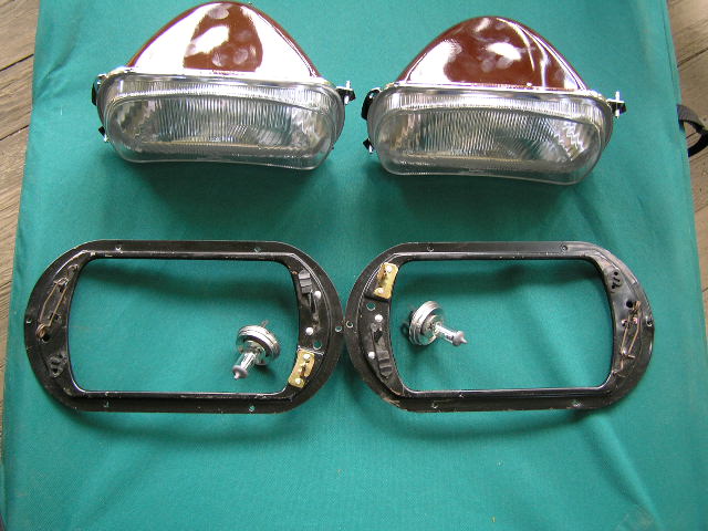

I used the Renault 12 headlamps, very close shape to the marchal. For the taillights I believe there is an outfit in The UK that has lots of them, Ricambio is the company name. I don't have their phone but ld bet some of the guys over there on the forum can steer you the right way.
If you need a pair of headlamps and mounts PM me I have a couple of sets..I will post a photo here.
