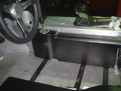

This is the covers we made for the Superformance GT40s, copied off an original car. Frank

Great picture Frank! Is the raised portion for the driver to rest his arm on while driving? It looks like it's quite a bit higher than the fuel tank.

It should sit on the inner edge of the sill panel, I think the item in the picture was not fully fixed, just pushed in for the photo, Frank

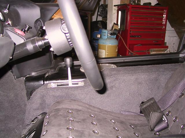

Bill I made my console lower as I am long in the arms.
I made it out of alloy sheet then had it covered it worked out well but not to hard to make it look original if you had to.

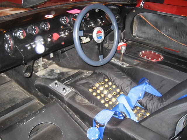

This pic of the red original car at the NEC Classic Car Show may give you a good view of the gearshift and "box" in an original car.

Damn Frank, that's beautiful!
