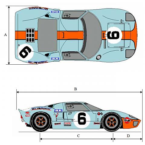

I'm embarking on a custom trailer build for a my RCR40 that is due in a few months. The trailer will be enclosed however the car I will pull all this with has a maximum towing capacity of 2,100kg. I need to make the trailer as small and light as possible. My towing vehicle is a new 4 door sedan with a 310KW 6.0Lt V8 so I will easily get up hills but I will pull the trunk off it if I exceed this weight!!
I would appreciate it if a current RCR owner with +2 rear flares could tell me the measurements below.
I know there are many lists of common dimensions like wheelbase etc. but I just want to make sure. DIM A is probably the only different one.
Dim A = ?
Dim B = ?
Dim C = ?
Dim D = ?
Front track (width) = ?
Rear track (width) = ?
Height from the bottom of the door to the ground when it is open = ?
I know I could try Fran but his email is pretty full at the moment and calling from Australia is too late at night.
Thanks in advance

Jason,
I have a +2, but it is under construction and the panels are close, but not perfect. As it is on the lift and wheels are removed, I can only give you A - D. Well, I can also tell you that from the face of one brake rotor to the face of the other in the back is 51" if that helps:
A = 71"
B = 162"
C = 96"
D = 39"
Hope that helps,
Mark

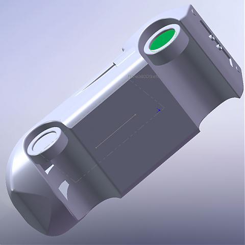

If anyone else could tell me the front and rear track of an RCR40 with 10.5" wider rears (& +2 rear arms) and 8.0" wide fronts I would be most grateful. That is measured from the outside of the tyre bead.
Just a very rough 30 minute CAD model to design the smallest enclosed trailer that will allow me to get out of the car! I'm thinking of making the trailer quite narrow with a door on the side to allow me to get out on the drivers side. Depends on the height of the door from the ground as it will need to clear the trailer wheels/guard to open.

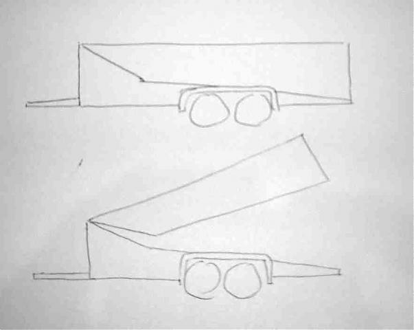

Jason
Have you considered this style of trailer?
Sorry about the quick sketch but I am sure you get the idea.
If it was made from light box tube and covered with thin ally it should be very light. If you use 14" wheels the door should open over the mudguards. You have no doors to make, just a hinge at the front. Asuming you load the car backwards you could reduce the height of the back to suit the car. Also you can make canvas sides to fill the gaps when the trailer is open to make a waterproof workplace. A slightly curved roof would add strength and stop drumming.
Brian.
