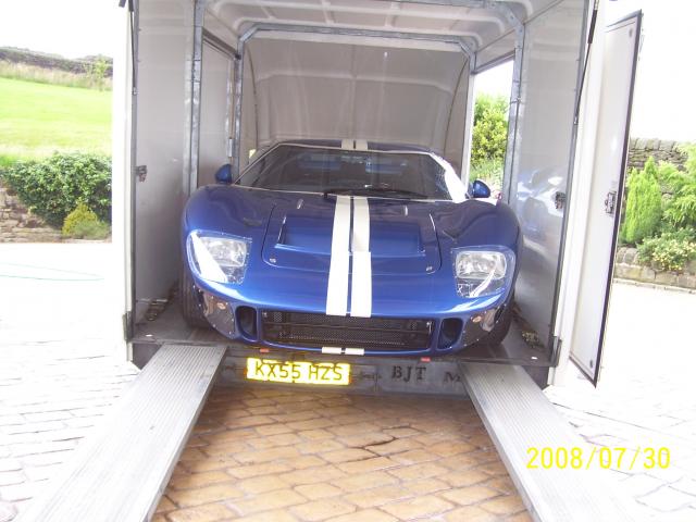

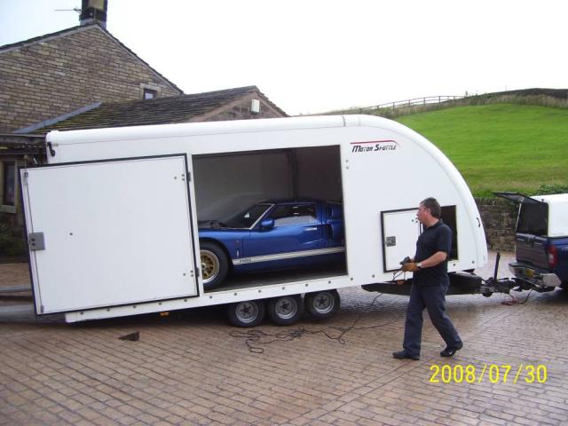

I had my car transported by a specialist who used this trailer that had a tilt bed and tripple axle; very shallow entry angle. The side doors allow you to drive in and then exit the side door. The top hinged door makes a useful shelter from rain or in Oz the sun.
It's made by Brian James Trailers their website has lots of detail that may be useful.
Steve
