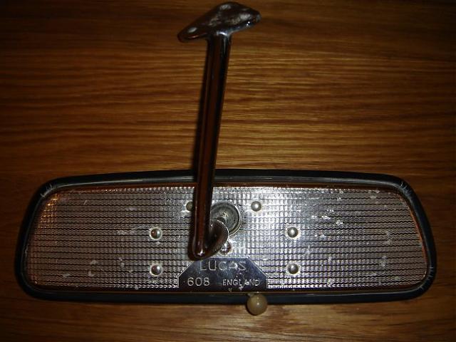

I got mine on ebay uk - the old mini's had them aswell I think. I was having the ally window post made up and thought I'd get a few extra made if anybody needs one £10uk plus P+P. They have an m6 thread already in the front - here's a few pics.
