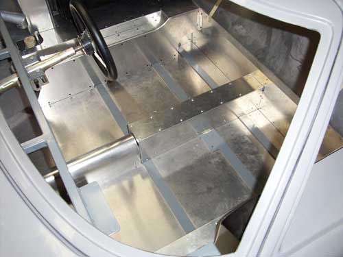

After reading elsewhere on this forum that seat mounting was appropriate using bolts through the Aluminium floor, I have decided to post this photo of my RF with bare interior.The photo shows the steel straps across the aluminium floor and these straps are drilled to take the seat mounts.The straps are welded to the chassis at each end.I also have the lower seat belt eyelets mounted to these straps.My opinion is that seat mounts and belts attatched to an aluminium floor would not be safe.
Ross

Ross, like your RF the GTD has steel straps across the floor through which the crutch strap and seat bolts fix. The other belt eyelets be they for inertia reel belts or harnesses all are fixed to steel chassis rails. Of course there is the position some take that the seat is held in as much as the driver by the seat belts so as long as the seat belt fixings are 100% the seat mounting is irrelevant! Evidence to back this up is that a lot of formula race cars have moulded seats that just sit in the chassis to pad the drivers bum and back. I would guess this position is only valid for race harnesses and not inertia lap belts. However you don't want your seat to move too much, if at all, when driving.....

The seats in my RF are mounted using 8 x M10 high tensile bolts on each seat (4 at the back and 4 at the front of each seat). Each bolt goes through the alloy floor and also the steel strap which Ross pointed out. Pain in the back putting the seats in and out of the car, but what price do you put on your safety. Each seat also gets a 6 point Sabelt harness which is secured to steel plates and the shoulder straps are secured to the six point roll cage.

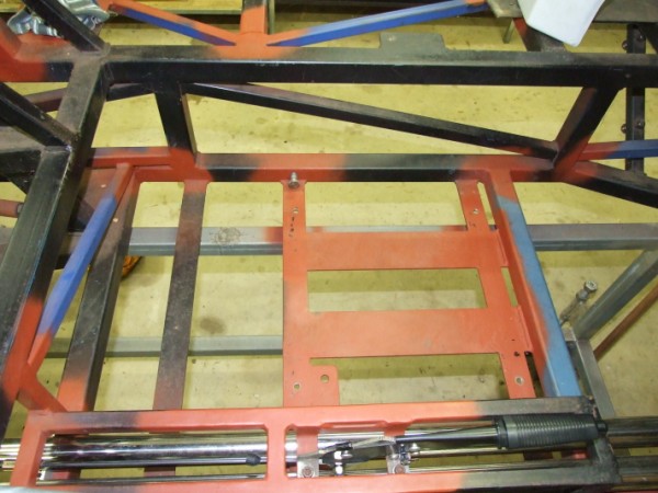

I also wanted a bit more protection from items coming through the floor. With the extra cross member (blue tube) and plates, the seats don’t move at all now and that’s without the 3mm floor.
The cross member is just under the front of the seats and doesn’t interfere with your feet getting in or out.
Call me paranoid
