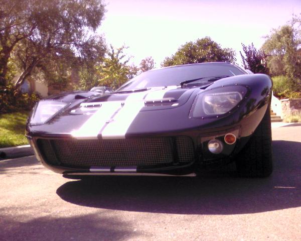

I used stainless steel mesh and attached it with J/B Weld.

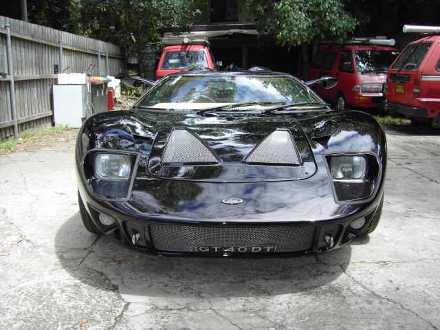

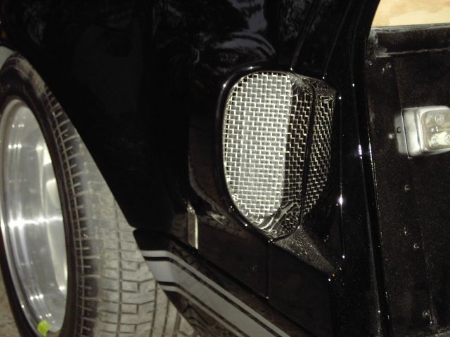

I have always held the view that there are two ways to do something.
The quick way. ( That usually doesn't work.)
The right way. ( This usually takes a bit longer but lasts and looks better)
( in the long term).

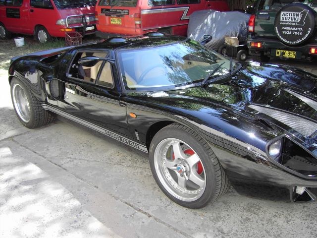

I fitted stainless mesh into all my grill and vent openings.
The main grill mesh was fitted by glassing alloy strips into the inside of the front clip and screwing into these strips for a secure mount.
The smaller openings that did not require foreseeable removal were epoxied into place.
None of these mesh pieces have or can fall off or rattle.
Given the interest these cars generate they are scrutinised very closely and as such demand a higher level of finish.
Only my humble opinions and thoughts.
Dimi

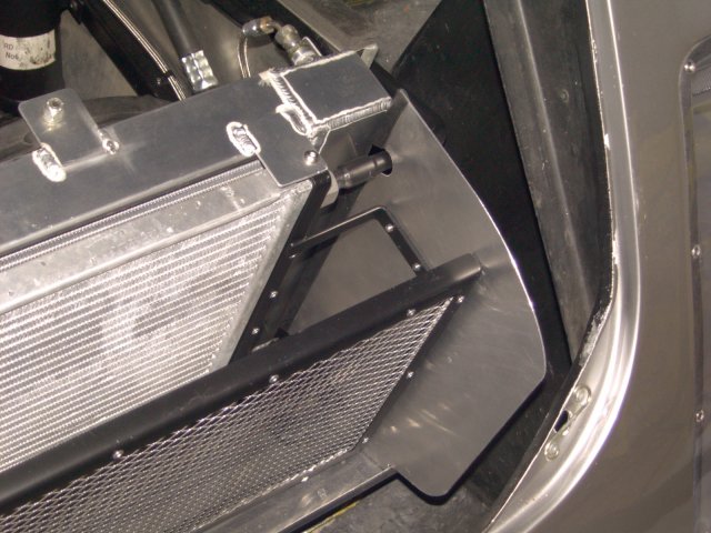

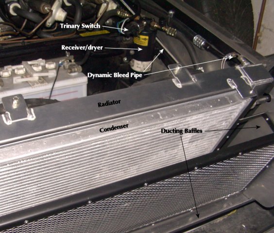

Tim,

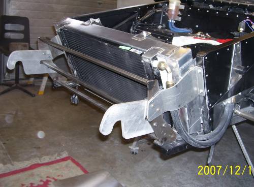

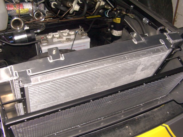

Here are pics of the setup that Brian Magee did for me when I replaced my GTD radiator with a Docking and moved the condenser in front of it.
In addition to the grille, which was a very simple affair, held on by 4 screws and nuts, Brian also fabricated baffles below and to either side of the radiator opening, which ducts air through the radiator and and not round the sides or below. It was to these that Brian attached the grille. The whole thing is invisible form the front when the clip is closed.
Tony

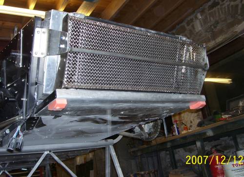

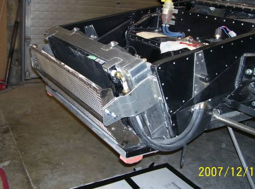

Tim

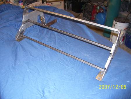

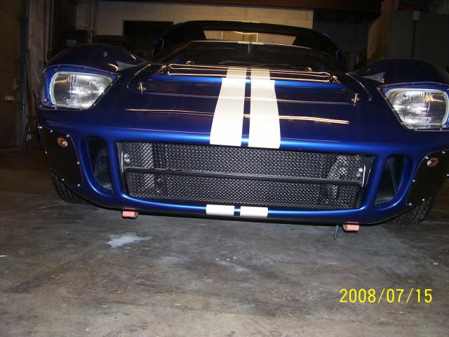

I made a simmilar item that fits to the chassis and shields the rad and condenser. It also carries a pair of jack brackets and a center cross bar to mount the registration plate. It is all painted matt black,
Steve
