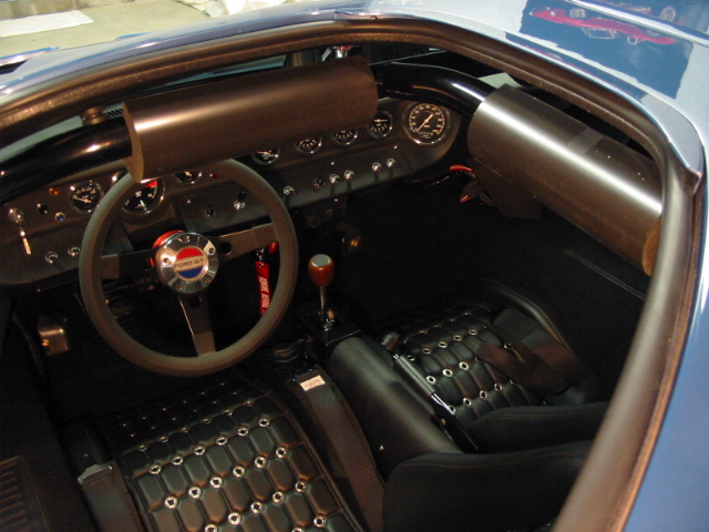

This thread inspired me. I would like to keep my noggin in one piece for a few more years. The padding is not that expensive and if you don't like it, pull it out. In the pic it looks a bit more intrusive than it actually is when sitting in the seat.

Nice work Chuck. You may want to use a couple of Zip-Ties to retain those pads as the adhesive doesn't always do the best job..
