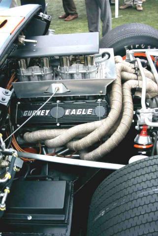

Hi Chuck,
Yep...this is an issue, especially with fuel and fire spitting webers. This is why they used the top pans back in the day.
Mike Pass
The proper glass rear windows are curved (not just a flat piece of glass) and all the ones I have seen fit very well in a wide variety of bodies from different suppliers. Most of the rear clips seem to be very similar around the rear window aperture. The best way would be to check one for fit in your rear clip.
The angled tray above the carbs on the original cars was not to keep flame spit off the rear window. The engines tended to spit a bit of flame on startup after a few good pumps to prime but the flames were quickly sucked in when the motor fired. The main aim of the plate was to help with stand off. Engines using webers can often have a stream of fuel particles coming in a stream OUT of the carbs at particular revs especially with a race cam. This standoff can drift away from the carbs which creates a hazard and can upset the mixture quite a bit. The plate ensures that the stand off fuel cloud gets back into the carb rather than it getting everywhere. Resonance in tubes is a strange thing and can be more relevant than flow along the tube. This is why inlet and exhaust lengths are so important.

Chuck,
Maybe this is what you're looking for:
Chuck,
I'm not sure. Probably polycorbonate Tuffak I would think.It's not my setup, I saved the pic from the archives awhile back.
Maybe the owner of the car will see the post and respond.
