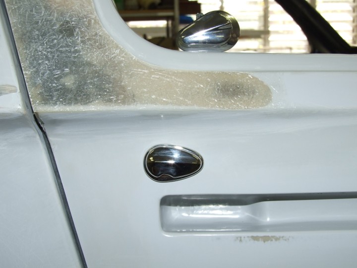

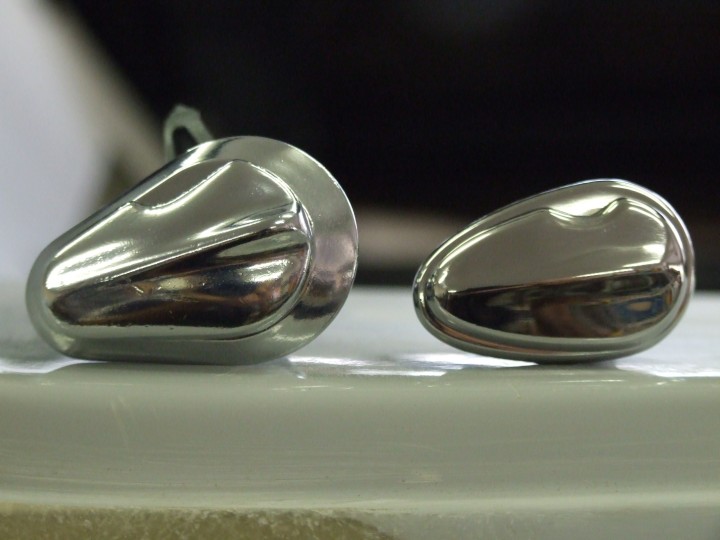

I'm in the middle of putting locks in the doors as well.
Bought a Rover P6 lock, but it seemed to have a very large base.
So I picked up a set of the Ford locks (copy this into Ebay - 140761922075)
and they seem to suit the space better. Haven't done the links yet.
Clayton

Clayton,
I would be curious to see what the lever looks like, that you made, to activate door mech.
Thanks, Larry

Larry
Once the mechanism is made I'll post up a pic.
Nothing there at the moment.
Clayton
