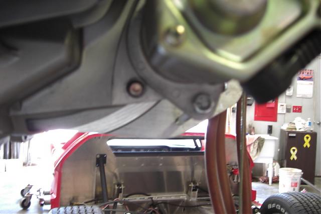

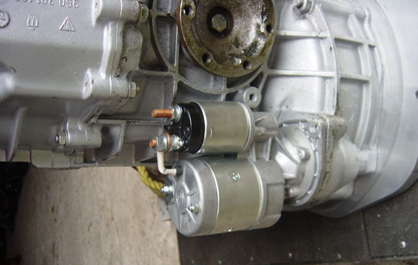

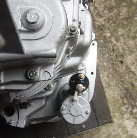

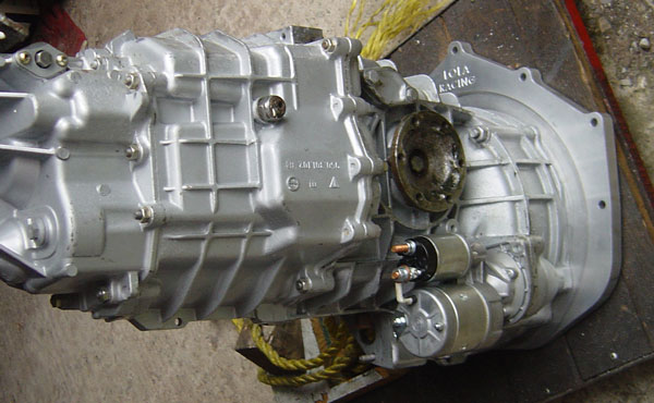

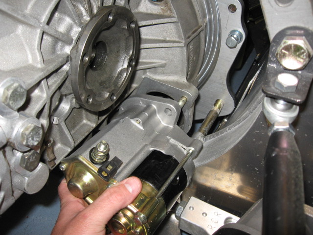

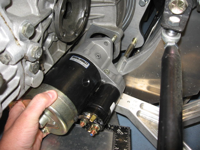

Ok, I'm looking for any and all suggestions of a way out of this situation I've got myself into. Have a look at the pictures below of my starter mount location and chassis. I need a starter that can go in there and not foul on the chassis. If I have to one-off something, I'm game.
The motor should be moved further back to accommodate a starter, but, I like where the motor is now. It lines up nicely with everything and I like it further forward.

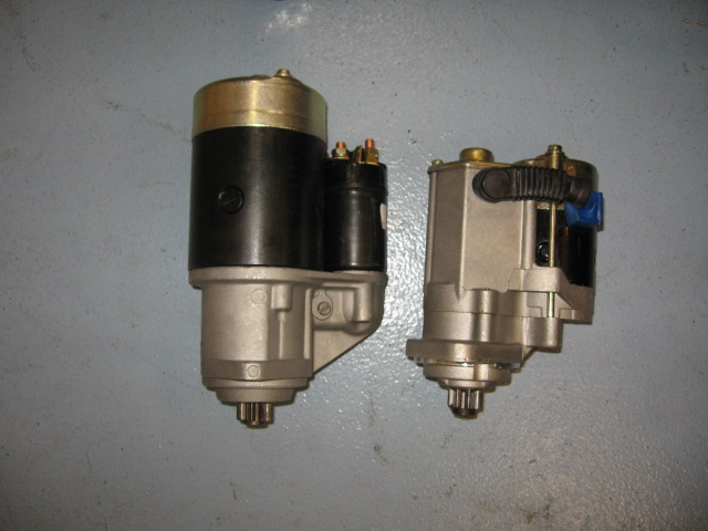

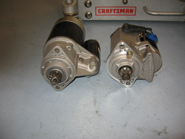

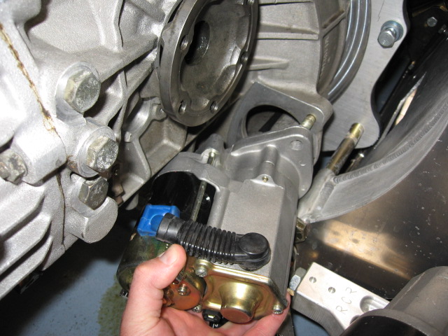

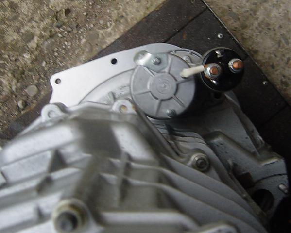

I know the starter pictured below will not fit because I bought one of those. It is not clockable. Jeff bought me a standard 911 starter that I'll have a look at tomorrow, but, I don't think it is going to fit either due to the solenoid.
The front shot is the ministarter I bought, the side shot black one is like the one I'll have a look at tomorrow.
Are there custom starter shops? Any clever, and not so clever, solutions will be entertained! :p:
Oh, picture is deceiving. The stater mount pocket is exactly inline with the front of the lower chassis bar when viewed from overhead. If you look at the picture it looks like it is maybe an inch or two in front of that, it is not.

Ron, it appears that the simplest solution is to simply raise the engine/trans the amount necessary to clear the lower cross member. I know that pictures can be deceiving, but it appears that you have the clearance up top for the water pump, alternator etc. Do you? I would not go with a one-off starter. How many times have you had to change a starter in your other cars? You can't run down to the local auto parts and buy a one-off. One-off's soon become two-off, three-off.

Ron, I'm pretty sure it is do-able using a Hi-Torque clockable starter from Kennedy or elsewhere. I have spent a lot of time looking at this for my own car. I too did not want to compromise my motor/trans position.

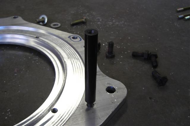

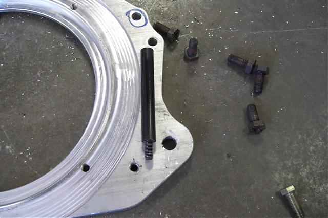

You will have to be a wee bit creative though. First the mounting stud on the bellhousing will have to be removed and swapped for a countersunk head cap screw. The starter mounting flange/adaptor will have to be removed from the starter and bolted up first after countersinking one hole. The threaded portions that receive the two small M5x45 mounting screws in the starter itself will need to be drilled out to 5mm clearance and and two M5 threaded holes tapped into the mounting flange/adaptor at the alignment you require. The screws then go in from the opposite direction to normal and bolt the starter up to the flange. A wee bit fiddly and the inside one is going to be a little tricky to get at. You will probably have to make a special allen key with a crank in it, unless you want to crawl under the car.

Moving the motor up isn't an option. The RCR car uses a mouting plate that adapts motor to trans, but it also indexes the hole assembly to the car with those big 5/8" bolts. So, the relation of the trans to the chassis can't change except fore and aft.
Russ, good ideas and description. Fran said about the same thing to me as well when I discussed it briefly with him too. Sounds doable, do you have yours done this way? My situation with the RCR car is unique with the Lola chassis, 930 transaxle, low Lola deck. Lots of things in there that would not cause a problem with a ZF, but, with as many combinations out there and then folks doing their own thing sooner or later a issue will pop up - and I made one. I'll get a clockable starter and check this out, have to sell the others I have. Anyone need some Porsche starters?

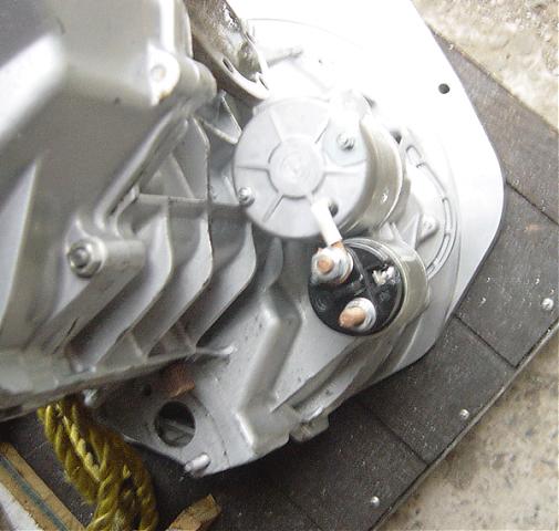

Here is a picture of a Kennedy Hi-Torque starter on a G50. Because the motor is offset (vs. the solenoid) and because of the mount bolt location, the $64K question will be if there is enough room between the mount bolt and the tranny case, and below the axle. Its hard to tell from 2D photos, but it appears that, if it fits, it will be very, very tight. I do think the hi-torque, gear reduction starter would be the best starter to use though.
Lynn
Lynn, missed that post and picture somehow! That one looks like it would foul to me, but it would be hard to tell just on photos. I could probably order it from KED and it'd be here in September, so we could trial fit it then!

Ron, if you look at Lynn's photo you will see why you have to remove that stud and countersink it, and fit the mounting flange first. So you can rotate the starter further anticlockwise. Having done that you'll find you've got plenty of room.
OTOH if a standard starter will fit without all the mucking around then that would be a good way to go.

I bought the starter pictured for my G50 box it is pretty compact only 6 inches long from mounting @ 5 inches across it has a throw out pinion but up to the job of starting a V8 it was made for the Ultima GTR may do the job for you, if you need any measurements let me know i will try and locate a supplier if you think it may fit.

I must have missed the pictures somehow or stopped the page from loading. That thing looks like it could work. I'll make some measurements of absolute dimensions from the outside around my starter area. That could be a off the shelf solution. I see it is clockable too. While the bolts are not symetric new holes could be drilled. I think that could do it!
