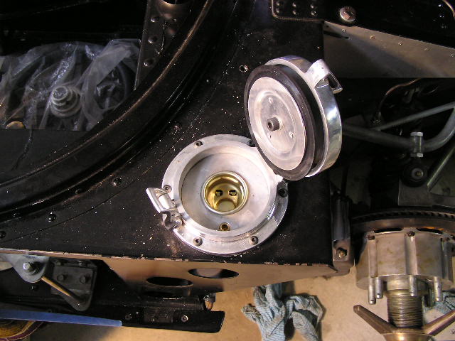

I ran vent line in steel tube from rear of tank to filler, see attached photo.
A sealed screw in cap fits into the ULP restrictor and prevents fuel sloshing up the filler neck in case of a frontal impact, the cast aluminium cap is just for effect and is not sealed when closed and latched. And it works as I tried it out !!
You could run the vent line to a carbon cannister (activated charcoal) which is then in turn connected to the inlet manifold so collecting fuel vapours.

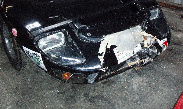

I notice that you have a piece of weather seal on the leading edge of the sil in front of the filler cap. Does it run the full length of the sil? If so, that would serve two functions. One to keep water out of the front clip, and two to keep any fuel spill or heavy vapors that might collect there and force them to the side and away from the clip. that is something that I am considering also.
What was the speed at the time of impact on the front clip? Do you think that was enough for the fuel to slosh up the filler tube? The reason I ask is some of the tanks are built with plates internally that form a vertical slit that slows down the movement of the gas and would absorb a lot of the force of the gas moving under impact. Instead of having 10 or so gallons moving at one time to the front, you would have a few hundred cc moving to the next chamber and so on to the next chamber leaving a gallon or two to exert pressure on the filler neck.

yes there is a weather strip mainly to stop water spray.
Hit a tree after breaking right rear lower wishbone, was doing about 90MPH when it let go so probably down to 50 at impact.
