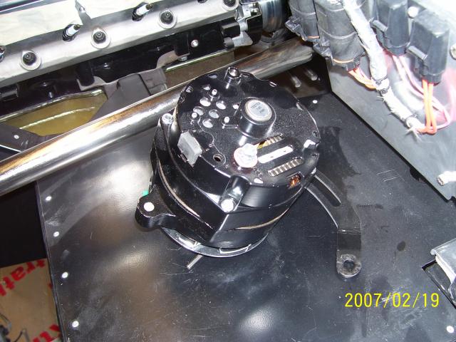

Failed alternator
After running for the 40 min the Enthusiasts Club had set up at Le Mans Classic with headlights fans pumps etc on, the alternator gave up the fight and died. I found out the next day as we drove back to ferry, the battery just made it to the port it all came to a stop on the dockside.

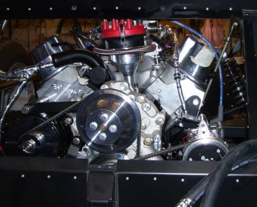

Here is the question. The unit on the car is the 100 amp Ford Mustang one wire ( G2? ) It is mounted on the rhs and is in confined space; the pulley is backed by a chrome disc. There are limited fan cooling blades but the alternator has little by way of cooling vents.
Has the heat build up and lack of cooling done for the alternator?
I have looked at some 100a UK one wire alternators (TVR & Landrover) they all have fan equipped drive pulleys and have plenty of vents to allow cooling air to be drawn through the body of the alternator.
Would this type be more suited to the task?
We made it home ( on a truck ) After a good long charge the battery has recovered; on start up the alternator was not delivering high enough voltage to produce a charge to the battery. however it did dim the ignition warning light, in the bright French sun it had appeared to go out.
Any help on this would be appreciated before I either buy a replacement or modify to fit the more vented type.
Steve

After trying a Landrover unit ther was just no room for it without some reworking of the engine bay area so I took Chris's advice and took the old unit apart. All the wires were in place, however the nut inside that secures the main 'battery' terminal had been hot and was not tight.
After finding the springs that flew out from behind the contact brushes I cleaned up the corrosion and tightened the nut then reassembled the alternator. You can put a split pin inserted from outside the cover to retain the brushes while the cover is refitted.
On startup the voltage was correct everything returned to normal.
I think the alternator was sensing the battery voltage through the higher resistance due to the poor contact, resulting in reduced output that could not charge the battery. The heat and vibration of the LMC track laps was the last straw.
I think the problem may have been with me for some time but disguised by my keeping the battery topped up with a conditioning charger. I think the voltage drop on the system was affecting EFI system as the engine now runs a great deal sweeter
I have noted that the single vee belt is now slipping and needs to be pretty tight. Has any one converted to the flat multi rib belts?
