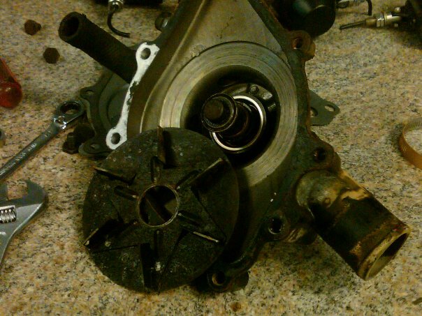

That won't do it. Mine didn't just slip and come off, it sheared off at the stamping where it bends and gets pressed on the shaft. The part of the impeller that fits on the shaft is still secured attached to the shaft.

For whatever reason, there have been chronic, repeated failures of this specific Edelbrock pump. I know of no other Edelbrock pumps that have this same self-destruct feature. A friend has a 408 Windsor in his Pantera, and he runs it hard on the track. I think he had FIVE pump failures. Unfortunately, Edelbrock is (as far as we know) the only one that makes this special shorter Windsor pump.
The solution is probably to use the Edelbrock casting and have a custom impeller made. :<(

Alignment isn't a issue. All three pulleys are within a 1/32" of each other on the same plane and as close to square (90 degrees to the belt) as can be measured. I would go of far as to say they are perfect. It's not belt alignment. Also the one bracket that mounts the alternator is in double shear and is solid enough to lift the motor out of the car with. Nothing is flexing. If you follow my posts you know I believe in battleship building techniques. A bit heavy but it don't break.
The two pulleys under-drive the pump at about 95% of crank speed. So shifting at 5500 puts the pump speed at 5225. The rev limit for the engine is 5800 so at max speed the pump is turning 5510. That should not fail a premium high performance pump from a top of the line performance parts supplier like Edelbrock. This is not a 39 dollar Kragen piece.
I run distilled clean water. Period. I live in California and it is rare if my garage falls below 40F. If it is really cold I leave the lights on overnight. Most tracks don't want antifreeze in the car. I takes time to clean up. Time is money.
The problem is the interference fit on the shaft isn't tight enough and with time the impeller just turns. Simple but that's it. It should be splines or keyed, simple again, but they must think that it would cost too much money per unit. Fuckin bean counters again.
Welding the impeller onto the shaft would work but the impeller is made of cast iron and the shaft is a really hard tool steel. Cast iron can be welded in the book but not so much by me. I tried to weld the first one and had a little success but oped for a new unit instead. Not this time.
It is just a bad design. The thing is, the rest of the unit is nicely made. Even the impeller is a curved vane thing that looks the part. Not the stamped sheet-metal piece that screwed Ron. It's too bad really. One more step, either splines or keyed shaft and it would be fine.

Originally Posted by Howard Jones View Post
By the way, what did Ford do in the 60's? After all theirs ran 24 hours. Have you seen any in-car videos on the Mulsanne back in the day? 1 min straight flat out each lap on that straight alone...........for 24 hours.
So I am not sure why what is happening is happening, but I don't think the piece is being abused outside it's design envelope.
Thats because back in the early sixties most if not all water pumps had cast iron impellors with curved vanes anyway, the 'race' versions just had slightly smaller OD impellors, then you hotrodder type americano's came along & invented the aftermarket & all of a sudden OEM was a dirty word, they the OEM guys didnt sell as much so they let the bean counters in the front door & your Genuine FOMOCO parts became a shadow of their former selves, looks like you got what you wanted!!
DIY Alloy Mono MKIV,406 FE,T44(R)

So Jac, ya got any 60 year old water pumps about? You always have a good tried and true idea for a fix. What do you think will work and what do you think about the cavitation thing?
