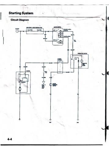

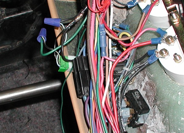

The switch will cost about $50. The wiring connector can be had from any wrecking yard that does Hondas. Look for one that is not a torch job. You will have to trace the wiring to find the piece seen here. I am including the wiring diagram for reference. If you can't read the print there are basicly 3 wires to work with. The black is gorund of course. The blue white goes to the relay coil wire of the starter. The ground wire for the coil goes to the clutch cutout switch for safety. It can be a stop switch like on a brake setup plumbed into the clutch hydraulics. The black white wire comes from the start or ignition switch.

Many thanks Bill.. I bought the switch from a fellow on the Cobra forum that decided against using it. I still need the pigtail. Now I have the instructions thanks to you!
I'll be making a trip to the wrecking yard soon...
