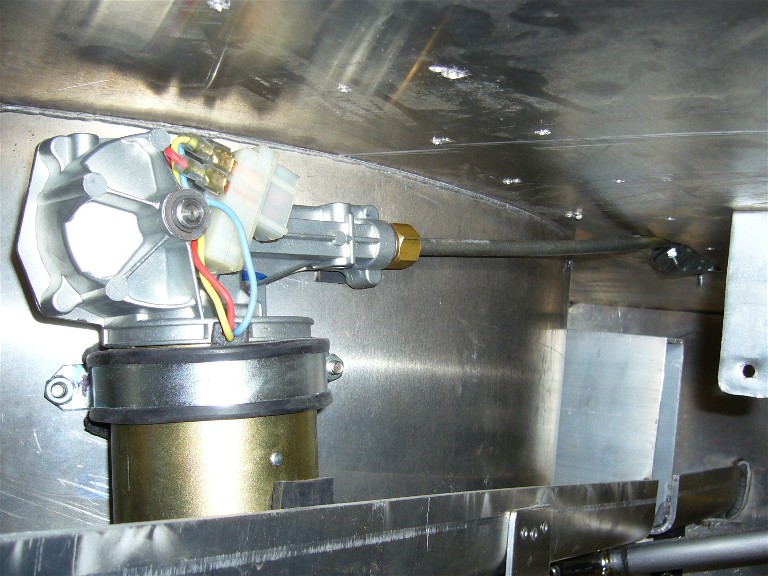

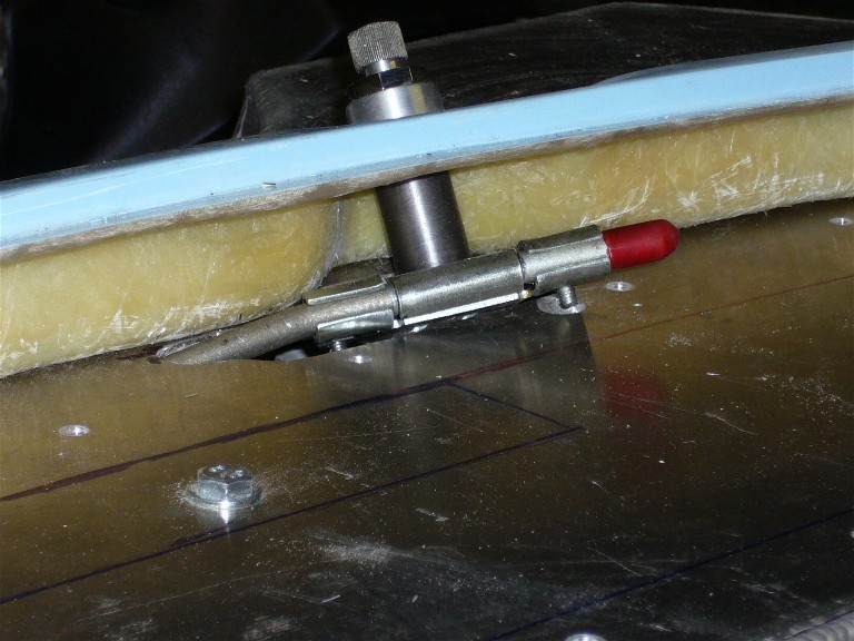

Re: Lucas Wiper Motor Placement
Bill,
I'll second Jonathans comments....."as straight as possible". Motor will run faster, under less load, and reduced chance of squeeking inside the tube.
Mine is installed an operational, I mounted it under the dash attached to the spare tire well. Here are a couple pics...
Perfect! Thanks Rob.
