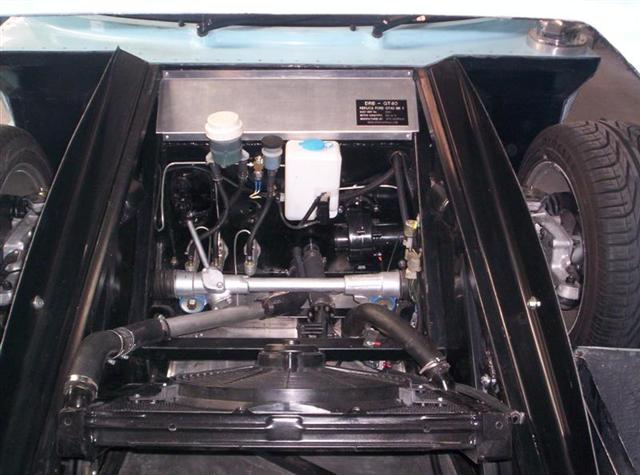

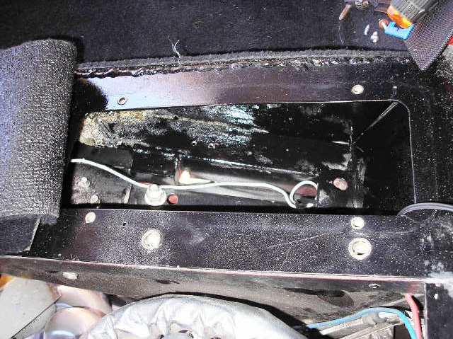

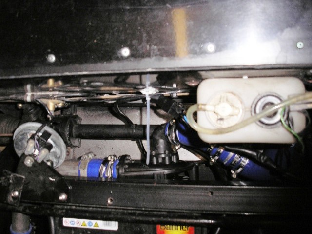

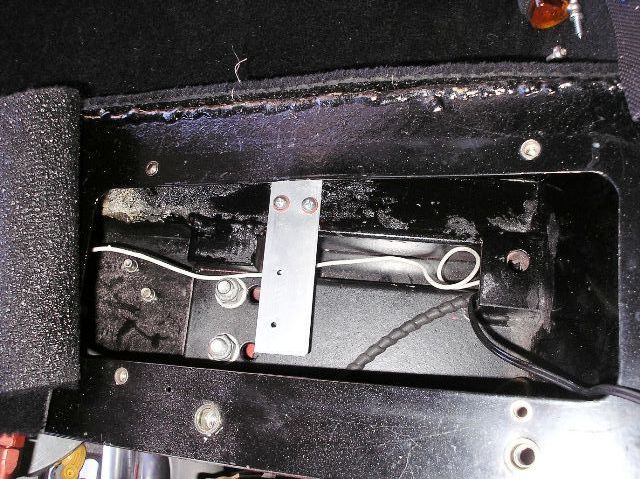

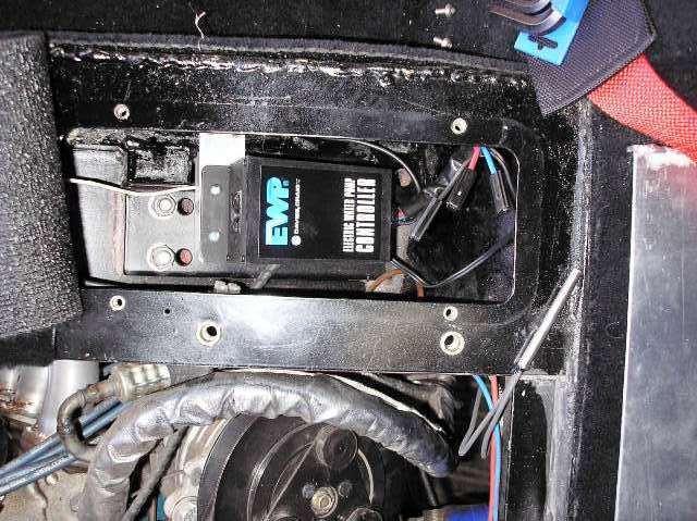

Here are some of my pics showing the position of the controller in the rear bulkhead. I believe that this compartment is not standard, and therefore would not suit everyone, but is admirably suited for positioning the controller and for running the cables into the engine bay and forward to the pump. The pump is mounted, as can be seen, just forward of the main front bulkhead and sits above the steering rack. As stated previously this is fitted into the supply pipe to the radiator, not the return, as recommended.
I hope this give you some ideas for your installation, but these photos are taken in its, as yet, incomplete set-up (I hate tie-wraps not trimmed back). My apologies for the pics being on their sides.
