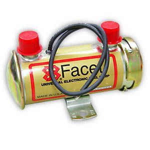

Posing my question another way, has anyone had recent experience with the Facet/Bendix pumps that they'd be willing to share with the rest of us? The pump I'm looking at (see below) puts out 45gph at 6 to 8 psi. Using Webers, we'll definitely need to drop the pressure to the 2 to 3 psi range. Thanks in advance...

I pressure tested the 2 facets fitted and both delivered 20kpa. Tried different springs and got to 27kpa. The Holley requires 40-49 kpa so I binned the facets and fitted Holley Blue pump with regulator set to 45kpa. Problems solved, and carburetion became tunable and ridable.
If your Webers require less fuelpressure than Holley you could be in.

What I mean is that measured at the hose where it enters the carb setup, the brandnew Facets were nowhere near 6-8psi. one psi being 6,9something kpa.

I have one fitted to my car feeding the swirl pot
It seems to run ok - really noisy when it sucks air under braking.
But the engine spec is reasonably mild compared to some and a max of about 270hp

I might be off the pitch here but I thought it was adviseable to use an in-line pressure regulator with Webers.
Most set-ups I have seen use a separate regulator in conjunction with the pump control to maintain fuel flow and pressure rates to Webers especially when using in-line filters after the pump.
