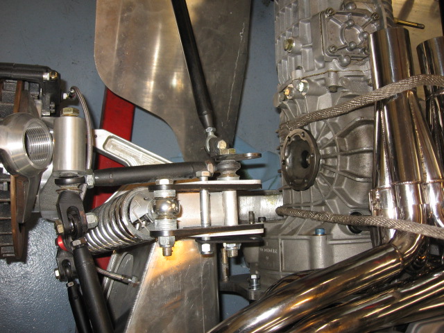

I've got the IHI starter in hand but can't check it. But you say I don't need too - the half shafts won't work in this configuration anyway?
I don't have half shafts, but I had not heard they won't fit. Problem is the cage is about to be fabbed up with the engine as is with a custom cross bar to clear the headers. If the engine absolutely must back back due to half shaft issues then I'll need to do that before cage work.
Here is an old top down picture of the alignment. It looks okay to me, but, I have never seen 930 half shafts or how they'll work around that area. I'd think they would work just fine, but I must not be understanding something about the packaging of the shafts and area there. It is tight as Jeff says, I'll ask RCR.

I can't really say - I have no idea of how much plunge the half-shafts/CVs support. I would assume that a custom length would be required in an ideal world (but that's a world I don't live in!)
Al

I don't think the half shafts will be a issue. I just looked at a ZF (Pantera) trans and the output flanges are about 10 1/2" back from the bellhousing. My G50/05 is a tick over 8". If you take a 14" shaft and move one end 2" the length doesn't change as much as I thought it would.

As I mentioned to a couple of you guys earlier today , we are now in the process of making our own shafts(due to crappy vendor service for months and months on end) and as such will be roll splining the shaft with extra length spline and we can cut the snap ring groove in any location to accomodate you unruly ones...we already have the ZF axles in stock in two different lengths .... hope this helps ease the confussion.
