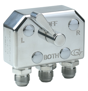

Fuel Tank Selector
Not the original but very nice.
Google Image Result for http://www.golanproducts.com/images/selector_marine.jpg

James,
Many of the items Golan Products are intended for the motorcycle market. So I would advise that flow rates and other specs be checked for use on a GT40. Ilan Golan has answered the phone himself every time I have called.
He makes some very nice things including the billet in line fuel filters that I use on my car (originally branded as K&N but now sold by Mr. Gasket; 10µ, 1.375" diameter pleated SS filter w/effecitive area of 6.2in² - 60µ available from Golan products.)

Re: Fuel Tank Selector
with up to AN10 fitting sizes on that selector, I doubt that flow rates are going to be an issue.. They don't sell direct from what I could find, but did find a distributor that got US $180 for that valve.. That puts it out of my reach..
I have the one JimmyMac posted. It is a work of art! Very well made. The only problem for the folks in the 'colonies' is the expense $450usd as I recall and that was when the dollar was stronger against the Lb. It has -8 and -6 sizes as well as a bunch of other odd fittings that are available. I have the duplex valve that allows -8 inlets to the pumps and -6 returns to the tanks. Not sure what the simplex version cost but I think they may sell it at Aircraft spruce.

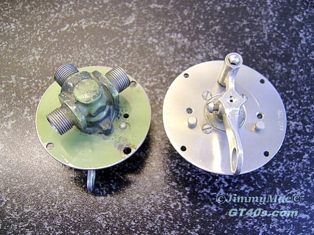

JIMMYMAC
Join Date: Jul 2003
Location: Scotland
Posts: 881
Rep Power: 15 JIMMYMAC is a name known to all
Ant,
Here's a couple of real ones up close.
Name:	Fuel - Fuel Tap (1).jpg
